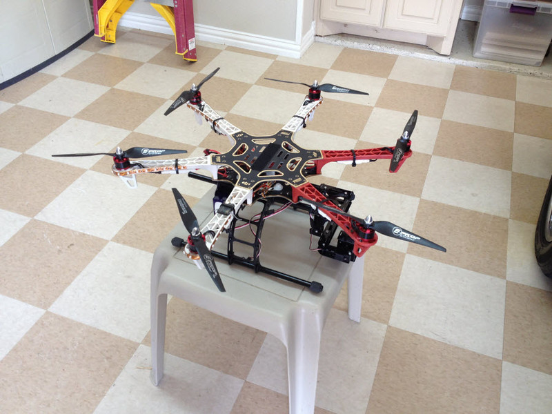

I added an aeroxcraft gimbal and gear to my f550. I'm running 4s 6000 batteries. Stock DJI 8 inch props. Was flying very good before hand, now it's wobbling all over in the wind and yaw is all over the place. Threw it into manual and hover was a good bit above half throttle.
Are these all signs I need to up my prop size? This is my assumption but wanted more opinions. I was about to order some 9 inch graupners, should I fire off the order or would 10 inch be better?
