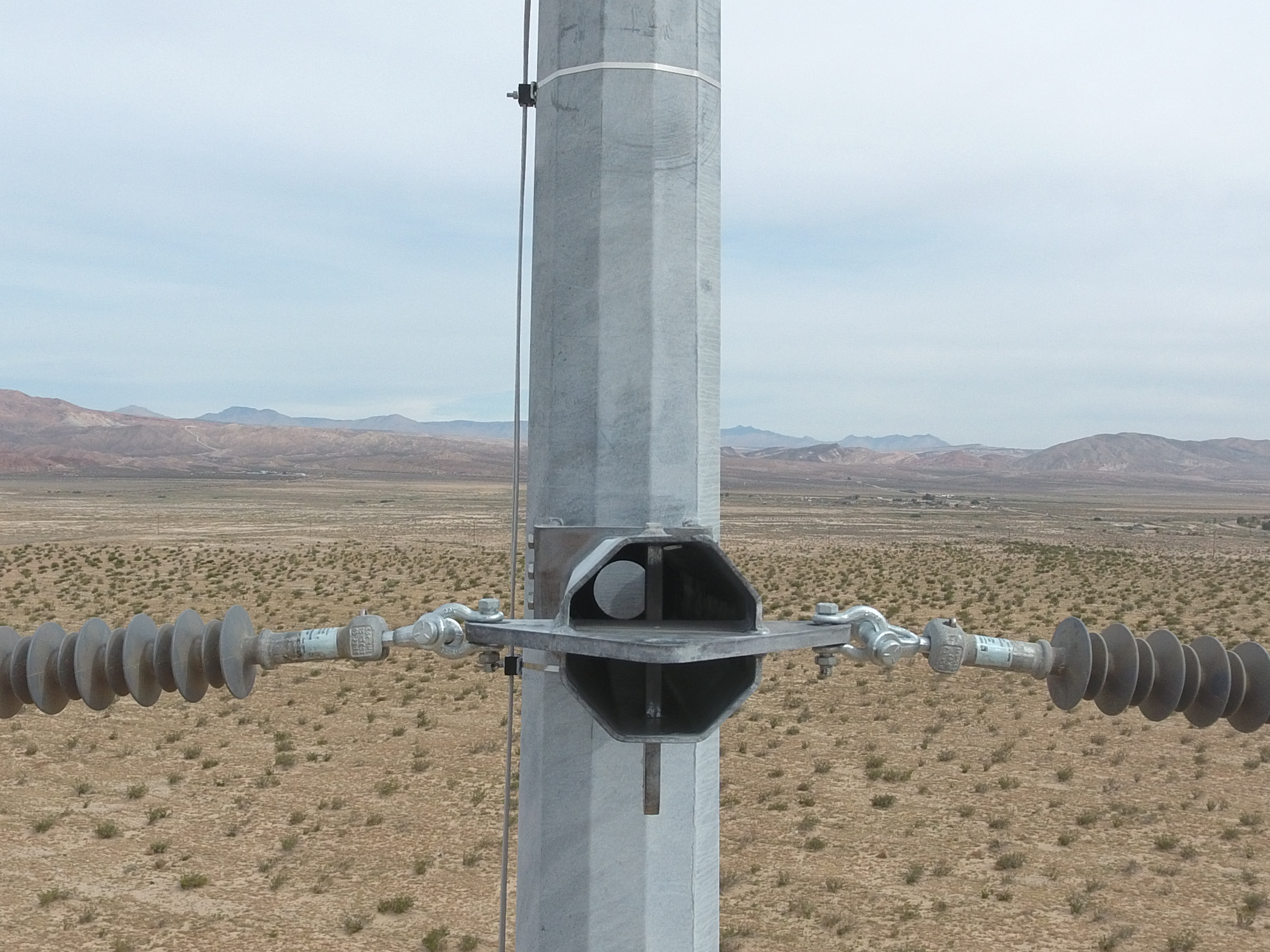

I have used an S1000 but I now prefer the Phantom 4 due to the redundancy, obstacle avoidance, and in worst case it's cheap. The photo below is from an inspection of a 115kv gen tie line.
Glenn Goodlett
As close as the P4 would get. Maybe 6 feet (2meters). I was incorrect about the line voltage, it is actually a 235 kv line.

Little off on meter feet conversion but I really like the result. How does P4 limit proximity? I like limit as I have crashed because of hitting what I was taking pictures of . Flying a QUV540G with a Vector controller. Oh for rough conversions a meter is close to a yard or 3-ft.
