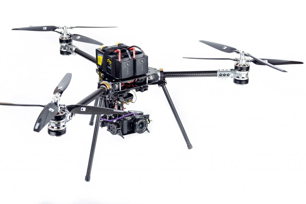

What is that model you are using? Is that something you had fabbed yourself? The motor config looks real similar to the Shotover I see the shafts are a little different. Just curious.
Av8Chuck
Yes we manufacture our own drones. Our booms are removable and that motor configuration allows us to us it on an amphibious drone, a VTOL and fixed wing.
