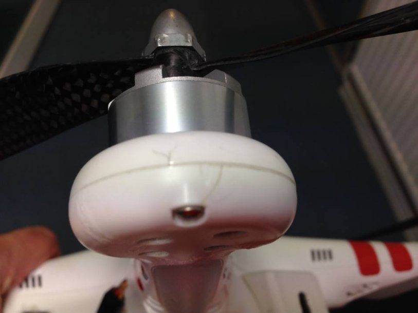

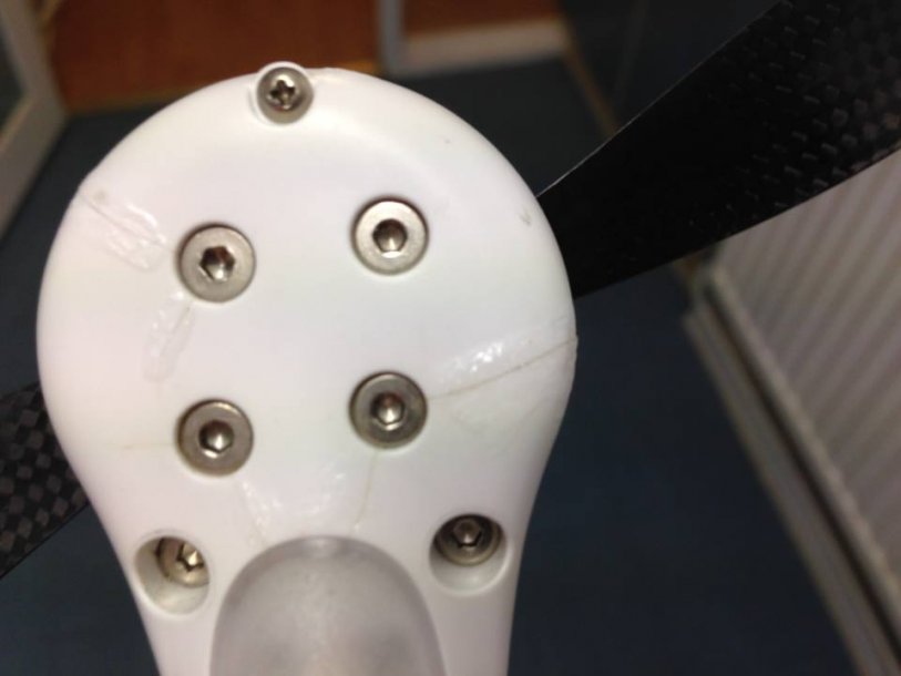

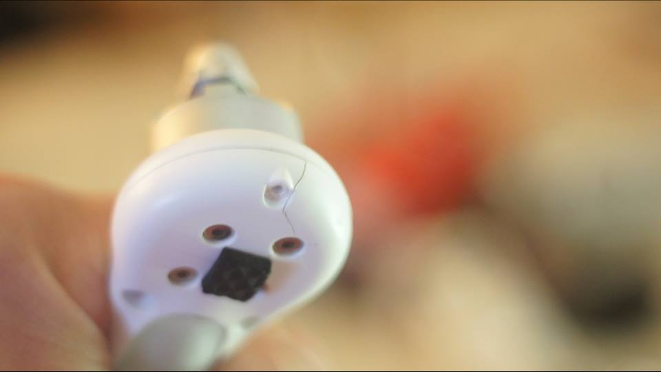

View attachment 21681 View attachment 21681 View attachment 21682 View attachment 21683 View attachment 21682 View attachment 21683 Hi, I know I am new to the forum, but I have been helping with phantom problems since the first one came out. Thread lock is a no no!!!! big sin... and it will kill your plastic on the phantom shell... I have tons of pictures of friends and mine which have had spider cracks etc that happened.. depends on how bad it is.. you might need to buy yourself a new shell and replace / swap out the electrics into the new shell... very easy job. I have put 3 photos of differant quads that all have cracked... none of them had locktight on them... but its the end screw that usually cracks if over tightened ...even by a hair.

Harvy
I have cracks in mine too.
What I have done is use Araldite and filled the inside of the motor mount to give it strength, not sure if it's the right thing to do but to spend £50 quid on new shell is a little too much don't you think.
jonrms
yeah I tried to fill it.. however now that you used araldite on it, it will most likely crack and break futher... if and when it does shout, I am in england... I will buy the thing off of you for parts.... I am always after them.. but good luck.
