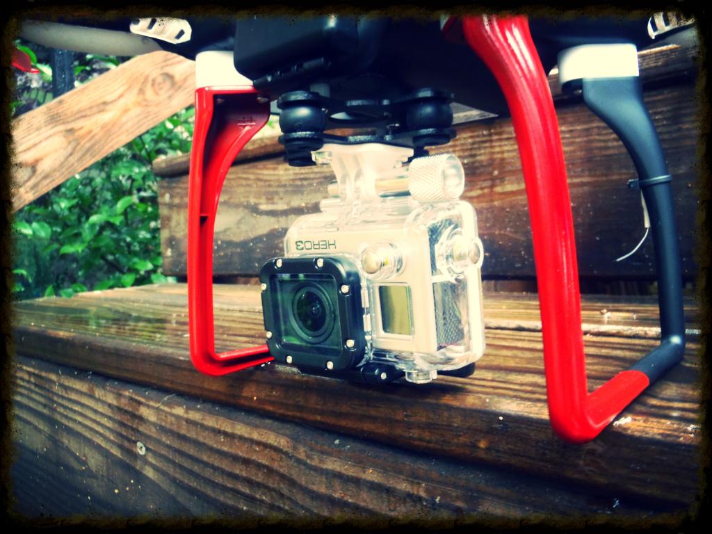

I decided to paint my Phantom. It was not as easy as I expected. I had to tape off the lights,motors and some screw holes. It did turn out nice in my opinion,but I would not try to paint a pre-assembled Phantom again. What is far easier is to paint a Phantom shell. I have one and painting it was a breeze. i will post pic,s once the build on that quad is done!
I flew the Phantom this afternoon in its pictured configuration. The Zinger props work pretty good. I will attach my GoPro Hero3 and test for balance/vibration,but the props being balanced are far stiffer than the stock DJI "white and black props". I would expect the resulting video to be jello/vibration free.
I have removed the nylon string seen in the pictures looped through the prop guards. The string sagged during flight,so I just took it off. It could also cause vibration due to downward prop wash and forward motion. I didn't want it to get all tangled up in the motors/prop,s. :highly_amused:

Wow now that looks good, you did a great job and by painting two of the blade guards red it has to help with orientation much better than the stickers they supply.

Paint = weight
Correct. Yet by my stop watch,I had 11 to 12 minutes of flight time fully loaded on a "Stock" DJI battery. I fly for video,so speed is not in the equation. Nice smooth fly by,s of the subject matter @ 60 Frames per second. I also fly with a anti-vibration mount and Gopro Hero 3 Black in its case. Stock batteries work just fine for my purposes.

Guards = Weight
Guards are very important for "Interior"video work. The added weight is not an issue. I really like the guards to be honest.I come in "Hot" way to many times on landing and the guards save the tips of my wooden "Zinger" 8.5 props.

Just curious to all these weight comments. Did you weigh before and after? would be interesting to see how much "weight" was added if very much at all.
Ohh, it looks much better then the white ones.... I like it and I am not keen on Phantoms. Good job on the paint.

About weight,I know it is of concern to some,but I want to have fun so do not pay to much attention to it unless I think whatever I add to the quad would somehow negatively harm its operation. I do weigh things that I add to the Phantom on a small digital kitchen scale before mounting those parts. I do it more out of curiosity than anything else.
173.5 Grams- GoPro Hero 3 Black in its factory polycarbonate housing with the long black factory handle with included steel screw and nut.
21.2 Grams -The DJI GoPro support cradle with included aluminum bolt and nut.
88.5 grams- The Gopro Hero 3 in its factory "Naked Frame" .
21.2 Grams- Aluminum anti-vibration mount with 4 rubber isolation balls with mounting hardware.
72.0 Grams- The DJI prop guards.
What may be of interest to some of you is what performance and handling issues I had when flying with the full GoPro Hero 3 package and the DJI props. I had an issue yesterday with maintaining constant hover and recovering from steep angle of attack. It turns out that the weather here played a big part in the performance of the quad. We have a major weather front moving through our area. The temp,s were in the low 80,s with close to 90% humidity. That high humidity played a big part in how the quad responded to throttle.
Now about paint. Another kind poster informed me about something I really never thought about. As I used "Tamiya Color" spray paint for plastic/styrene, most of the weight comes from the solvents that deliver the pigment. Those solvents evaporate. So in reality the paint,s weight added to the quads body is very,very small!
I think performance wise the Gopro Hero in its factory "Naked Frame" works best weight wise,yet leaves you with zero lens protection. I do believe the quad with 181.70 Grams of added weigh ( DJI prop guards,Anti-vibration mount,Gopro Hero 3 and naked frame) will not affect overall performance.
