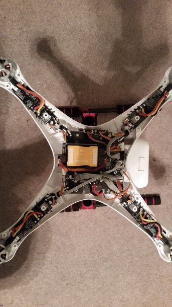

ncdude
Here is the picture of my drone with the top off. Hope you all can see what I need to get the fpv going.

scott,
that looks like it's a NAZA V2 so ti should have the PMU and canbus hub already in there.
