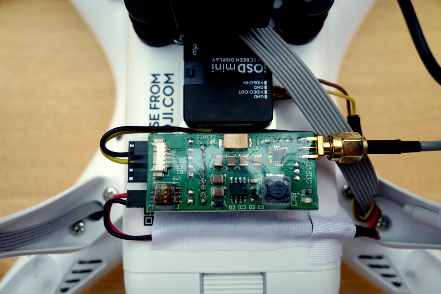

Christmas came early! I received my Phantom 2 with Zenmuse H3-2D gimbal from Geoff at Quadcopters on the day before Christmas. Gale force winds and rain here in the UK so it was Boxing Day before I could out to carry out a couple of test flights. Erring on the side of caution I flew the first two flights without the gimbal and I am pleased to confirm that DJI's claims of 25 minutes flight time are correct. My first flight taking the batteries to 25% lasted 27 minutes. My second flight flight flying more aggressively lasted 22 minutes. I'm well pleased.
I fitted the gimbal (10 minute job) and the added the DJI iOSD and Immersion transmitter. DJI have made the job easy with a Can-bus connector for the iOSD on the leg and a short bare ended link cable with power and video feed from the Zenmuse poking through the bottom of the craft. No need to dismantle the Phantom. I just cut, soldered and heat shrinked the supplied cables (see attached photos). We are still experiencing dreadful weather in the UK and I've only had one flight with the added kit. Flight time with the gimbal, OSD and transmitter was around 17 minutes.
IMHO DJI have a winner!
