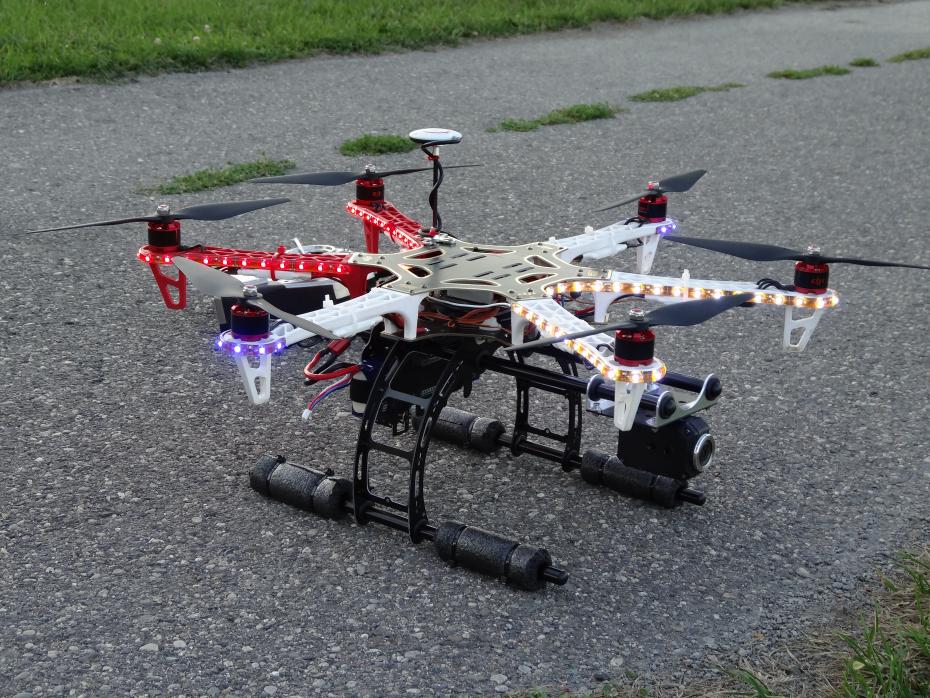

I recently built an F550 and not sure what my maximum payload would be, im looking at lifting a body and lens of about 350g along with the aeroxcraft landing gear and a gimbal suitable for the job.
Right now I run a single 3s 3000 with the 10" props, what would I be looking at changing to lift this payload (for as long as possible :D)
ari
I think it's around 2.4kg maximum total craft weight (including battery and everything). There are some heavy lift conversions you can look into.
I am using a DJI F550 stock motors, 10" props, stock ESC's, Naza-M v1, a 3S 5000mha battery, Areoxcraft landing gear, lots of LEDs, and a camera. I have my timer set for 9 minutes and land with at least 11.4v and putting about 3500mha back in to charging. I do plan on getting a brushless gimbal and video tx on it as well in the near future. Now this is 9 minutes of me actually flying it, not just hovering around. I like to fly and push my F550.
