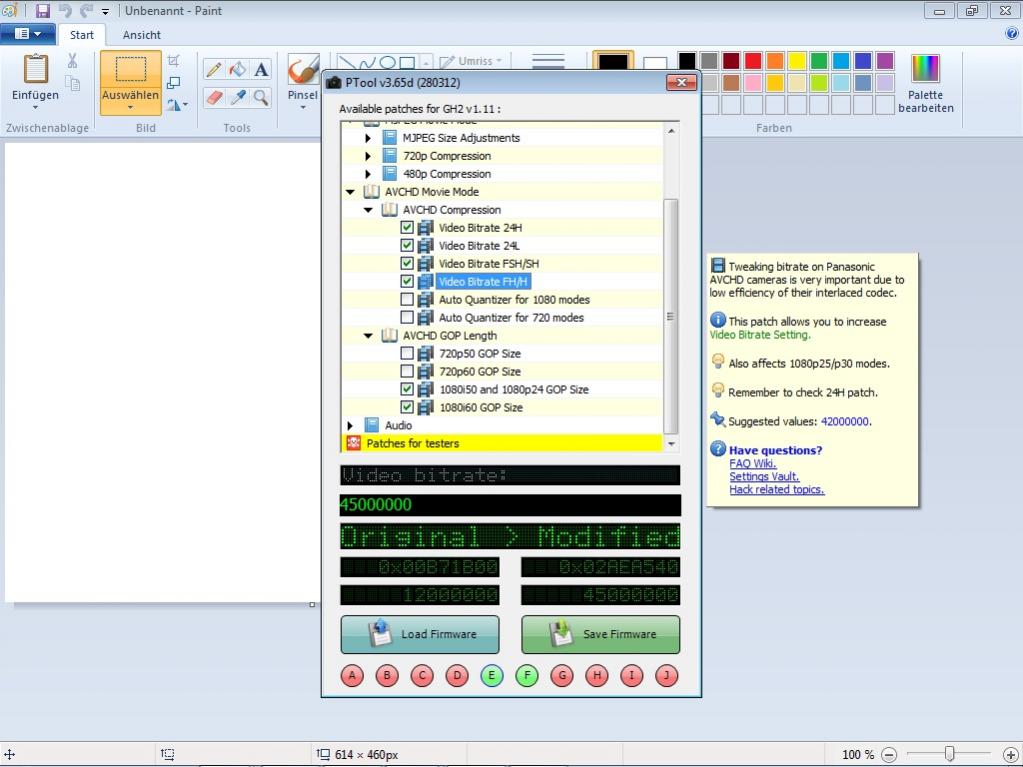

You can modify the bitrates, gop, etc in the ptools.
Currently I'm using the Unified hack with a lowered 44Mb for for HBR and 720 60 SH with GOP3.

Guys it this the right approach ?
I get the unified hack loaded than i tweak the setting for 720p60 GOP size and Videobirtae FHS/SH ? I am just wondering why 720p60 or p50 are not check after loading the 88 unified ? I am i misunderstanding something here ?

Anybody any success with the 88mbit unified hack. Try this a couple days now always spending when time a couple minutes and re-flashing the camera with a lower mbit setting or GOP. But i just cant get my camera to be stable. Most of the time when the GH2 is actually in movement it crashes. Anybody got it to work at what mbit setting and GOP or someone willing to share their firmware build they used for it.
using the extreme pro 95mb/s 64gb in all my tries.
