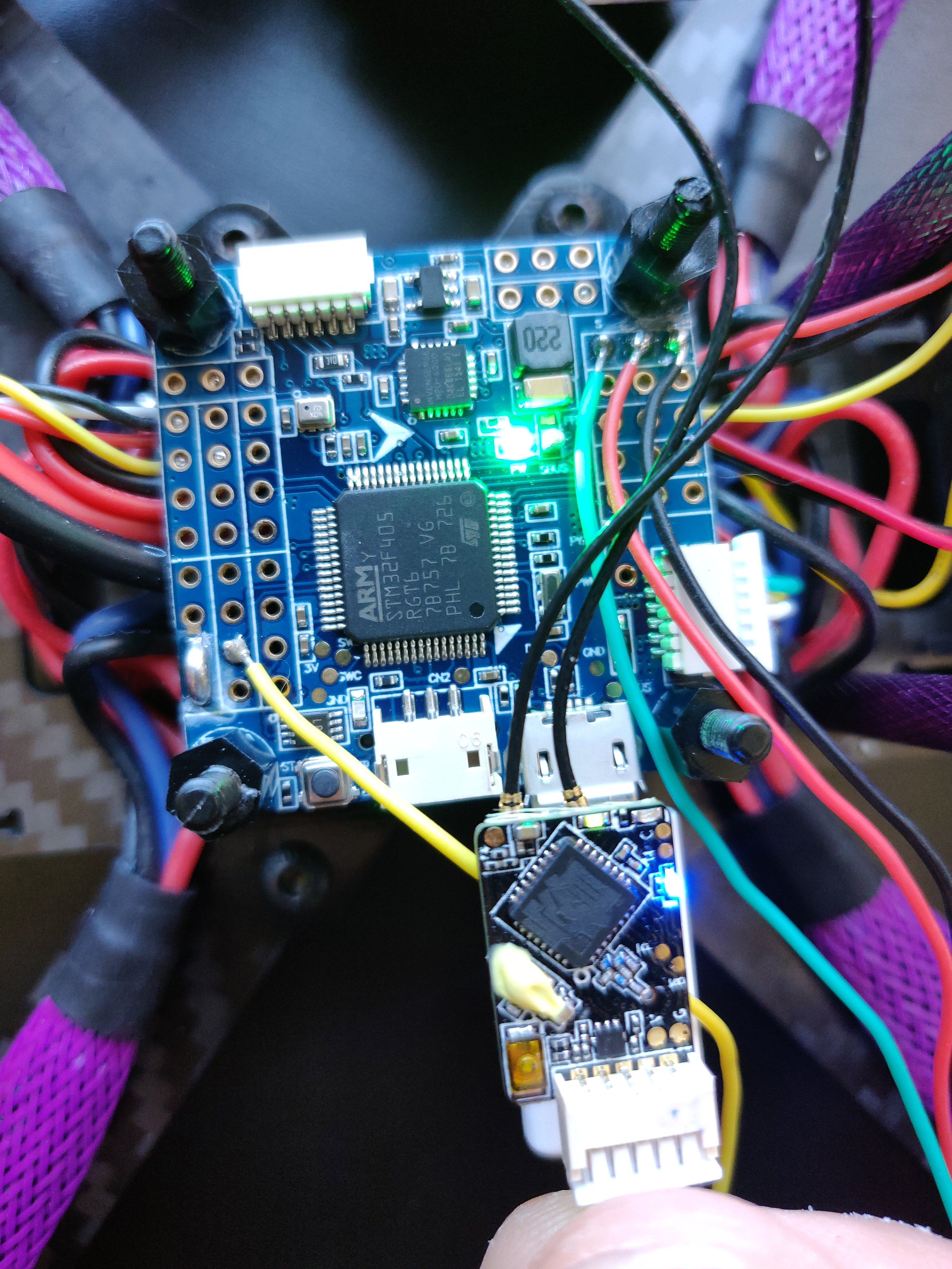

In regards to the attached picture: This was the state of my FC and receiver during the majority of my trial and error via Betaflight. I tried posting this to rcgroups previously, but it's been over 24 hours and the post still hasn't even appeared in the forum so idk what's going on there. Since then I decided to cut the yellow wire and solder it to the receiver's negated "P" pad (aka, the "uninversion" hack)... Left everything else as pictured, still no dice. I'm hoping it's just a matter of swapping a couple wires on the FC or something, because in terms of software, there is nothing i haven't tried.
