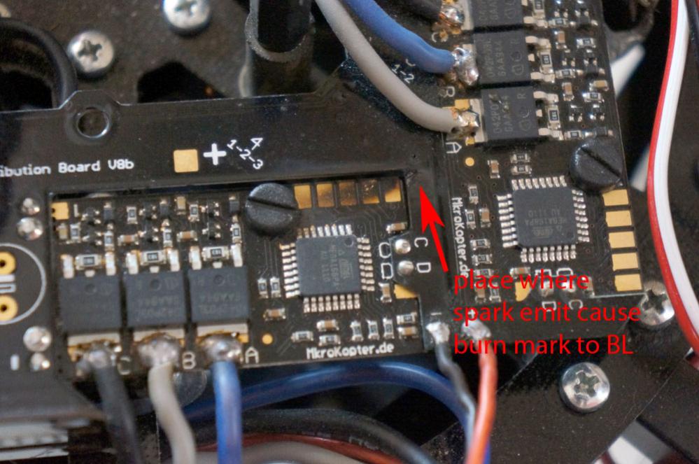

This is a first incident happen to my MK OKTO XL after 6 month happy flying.
Few days ago when I bring down my okto to site for a job, upon lipo plug in, there a smoke emit from the some electronic underneath the dome. After checking and bold enough to retest with lipo plug in, I noticed there is a spark fire emit from the PBD ring and throw some flame that cause some burn mark to the adjacent BL.(pls see photo)
As this a a ARF kit I purchase from a shop, I truly no idea what cause this? It seem like there is something wrong with the PBD rather than the BL to me(that's my assumption)
View attachment 5042View attachment 5043
I truly wish to learn something from this instead of throwing the blame to the shop who do the solder job for me.
Could it be overload of current? I have 4 strip of LED, 1 BEC 6.5v and 1 BEC 12v that power a HDMI converter to RCA and video transmitter.
It carry MK SR2 camera gimbal with Sony nex5n often(which consider very light for okto xl)
It record about 100 degree celcius on previous flight session which suprise me.:dejection:

fsimao222
Hi,
Have you already check under the BL?
Have you already take the lipo off to see if the flames come from there?

yeow
I have check the underside of the pdb and Bl and find no burn mark or anything. As you can see the smoke stain on BL is cause by flame shoot from a small hole from pbd
Yes. I had remove the dome often to connect mktool or doing soldering job for extra LED and bec and other task
ZAxis
We suffered a similar burnout on our y6 last month. A LED strip had it's connecting wires pulled in a heavy landing and the power to it was short circuited by the carbon fibre frame. The LED drive transistor went up in smoke. It was the weakest link in the circuit, perhaps on your's it was the PDB tracks.

ZAxis
Andy, what do you mean by LED transistor?
For my case, any advice what should I do next? I guess the PBD need to be dump and rebuilt the PBD ring with the BL again right?
The LED transistor is an option on the hexa PDB to allow the LEDS to be switched on/off from the Flight Controller. The Octo PDB seems to lack this feature and the LEDs are simply powered straight from the battery. For the Octo you need to use the Extension PCB (Link), this gives an additional layer of isolation between the LEDS and the battery.
Anyway, damage to the PDB is not good and I would seriously consider having it replaced. You just don't know what else has been affected and since the board is there to pass the control signals to the BL motor controllers it is ' flight critical'. You or your shop still need to figure out what caused the problem in the first place. A short circuit of some kind is still the leading contender. Check your LED/BEC/etc wiring carefully.

yeow
Hi Andy,apreciate your advice, oh, now I know what is the transistor,I do have the extension PCB which I never solder it out as it too tiny soldering work for my skill. A close examine show that the hole where spark shoot out is the passage of a circuit line bury under the pcd coating, contacting the shop to see is this still within warranty.
