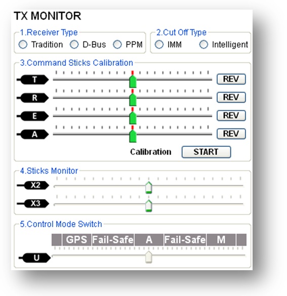

The Wkm does a calibration on power up. Maybe the ship was rocking too much when you plugged in the lipo. I always monitor the sticks on power up. Sometimes they don't stay centered and I need to unplug and start again.

What do you mean the the sticks don't stay centered? Which sticks?
Interesting. So you plug into a laptop every flight?
I either use my Surface pro or use the bluetooth and ios app. I never lift off without checking the sticks. 1 in 5 times the sticks are either slightly off or jittering.
