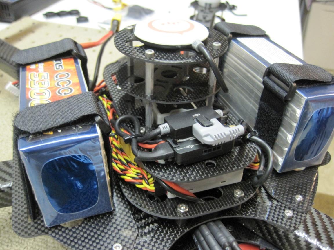

Hexacrafter
Manufacturer
We mount ours like you describe, but start out high & lower by using shorter standoffs until we keep contant GPS. Too close and GPS signal will cut in and out. This is about as short as we can go.

gringers
Preoccupied
Ok, thanks for the info. Looks like mine needs to be at least another 40mm up but nice to know it's probably not down to the way it's mounted. Will continue to play around with different standoffs/positions and see whether I can get an improvement.

gringers
Preoccupied
Just as a fyi, I finally had a chance to play around with the puck position and indeed, raising it up a bit more made a huge difference. Rock solid 8 sat GPS lock, sometimes, 9.
Thanks for the tip!
