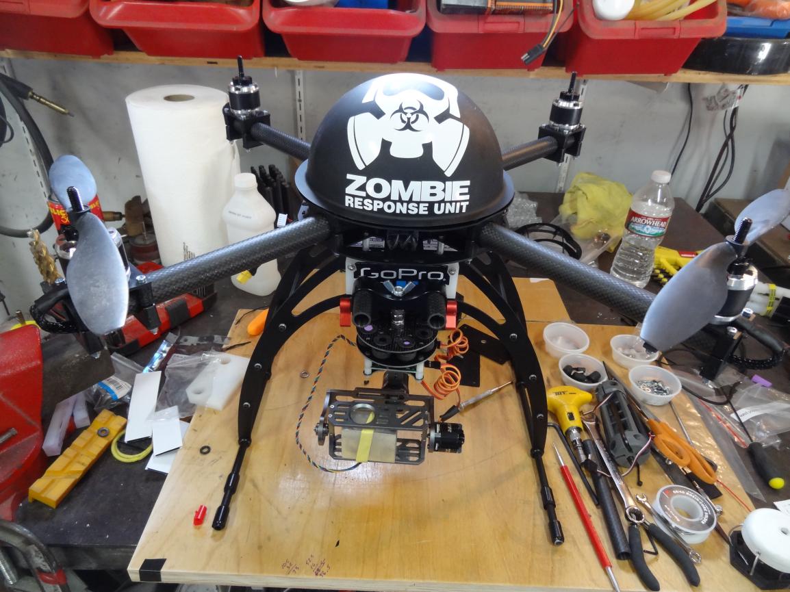

Here's my newest lil beasty...
Quadframes heavy weight quad...http://www.quadframe.us/collections...ight-quadcopter-frame-with-21-5mm-carbon-arms
Quadframes 200mm landing gear...http://www.quadframe.us/collections/landing-gear/products/200mm-clearance-landing-legs
I Power 2814Q motors...http://www.gothelirc.com/shopdisplayproducts.asp?id=135&cat=iPower
DJI 30amp opto esc's
RCtimer gopro gimbal from uavobjects running the martinez BG board (just got it hung today and haven't tried it yet).

tstrike your setup looks awesome! hows your flight time with that baby? and how much did it set you back? love the frame and legs but they are a bit on the pricey side for me :(
tstrike
pendejo grande
Don't know flight times since I haven't got it off the bench but I figure around 6-8 minutes safely running a 4000mah 4s spinning 10's. It's getting one of my naza's for the
fc. A lot of the gear I had already, motors, esc's, naza w/gps etc. I haven't had a proper kit in like forEVER (even the disco I had was a burned out frame I got from kloner for like 20 bucks) and wanted something portable strictly for the gimbal.
Im now regretting buying this heavy cumbersome frame....kind of want a hoverthings HT-FPV now. Only 350g. 6-8 minutes of flight time just wont cut it for me!

I have the same quadframe "heavy" frame as tstrike and the same legs. I get around 15-20mins "non aggressive" flight on 2 x 4000 6s (which *just* fit in the battery bay of the legs) , powering 3508-29's (380kv) and 1450 CF props. I will upgrade to a single 11,000mah maxamps (lighter + more amps!) to give a solid 20mins with gimbal and gopro.
So yeah...big, powerful batteries required! The 11a battery alone weighs 1.3kg, and that's an improvement for me.
My question to tstrike - what is that mount you have attached to the front of the legs? I need one! Need to choose a Brushless gimbal and that looks the more standard mount rails.
Edit: question 2! You have excellent paint skills; what did you use on the dome? Normal Tamiya polycarbonate sprays and primer? I need to paint mine...

Thanks, the mount is a standard 15mm rods @ 60mm spacing with a rail block from an old shoulder rig, I wanted to be able to pull off the gimbal without
any tools. I drilled 15mm holes in a piece of pvc bar stock and the rails fit tight (they're stubby and don't go into the battery bay). The paint is just black primer out of the can sprayed inside and out with a sweet sticker I got at the zombie apocalypse store in vegas when I went to nab.
If you're ever in vegas, check it out, just west of I 15 on Warm Springs Road-take the kids, it's FREE!
What arms are you running? I'm using the shortys but have a ton of tail booms to go longer when the time comes.
I'm running the 370mm 21.5's. Unfortunately Jakob brought out the 25mm version two weeks later (I'd have preferred those, as they have double the thrust loading).
Re: the mount - ahah, ok - nice build then. I was hoping these were off the shelf :(
