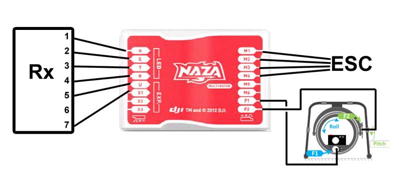

Thanks for the video, Gunter. Where do you have the two gimbal servos (roll & pitch) connected? Are they plugged into the Naza F1 & F2 ports? If so, how do you map the pitch servo to a channel on the Rx (hence a knob on the Tx)? Looks like maybe I connect port X1 on the Naza to the appropriate channel on the Rx...is that correct?
Thanks for the clarification.

So does this diagram represent to correct connections for hooking up a gimbal? In my case, I'm using a Futaba 9CAP Tx where Channel 5 is a 2-position toggle and Channel 7 is a rotary knob.
Where:
Rx Channels 1-4 are aileron, elevator, throttle, & rudder---connects to Naza A, E, T, & R
Rx Channel 5 (in my case) is mode---connects to Naza U
Rx Channel 7 (in my case) is gimbal pitch---connects to Naza X1
ESCs connect to Naza M1, M2, M3, & M4 (in my case)
Gimbal Roll servo connects to Naza F1
Gimbal Pitch servo connects to Naza F2
Thanks for all the help, guys.
Jack

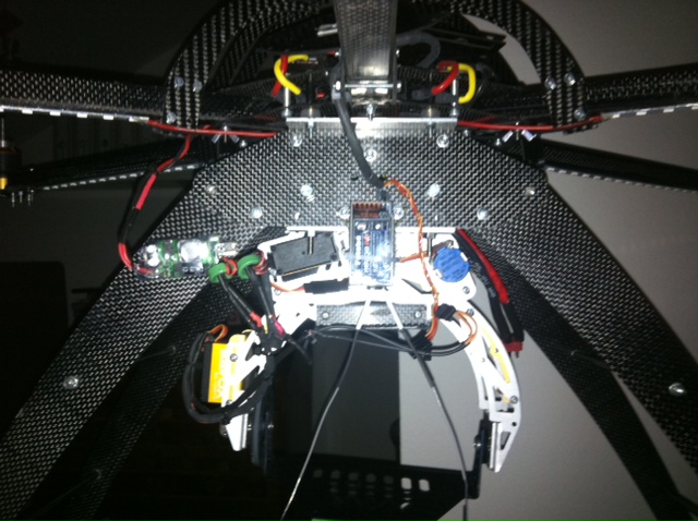

Gunter, what servos are you using for your camera gimbals. Yours seem to move much more smoothly than the HS65MGs that I'm using.
Harv
Gunter
Draganflyer X4
Harv
Harv,
They arent as smooth as they look! They are cheap £20 Futaba servos from hobbystores. They are fine for photography but not ideal for video.
Regards, Gunter
