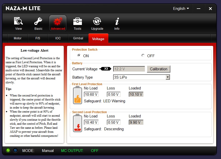

I've just built my first quad (which was tough but fun and rewarding) and I've left off the VU that comes with the NAza M Lite...so I now can't/don't get the voltage warnings.
I have tried to wire the VU to the PDB and conenct up, however, when I then go through the Naza Assistant, it does not register the battery being connected and hence I can't therefore set the voltage limits...
