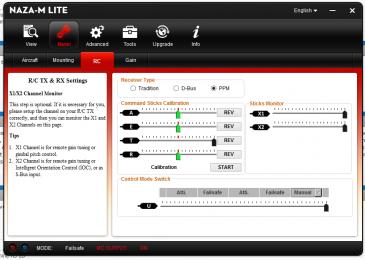

If you meant "PPM" mode, then yes, I tried that, too. In fact, I tried all of the modes: Tradition, D-Bus, PPM. It never responds to the moving sticks. I wonder if this means that my receiver is dead. I'll try to test the receiver using Arduino. Attached is a screenshot of my Naza Assistant RC screen. If you really meant PWM mode, I can't find it in the software. Would you please let me know what tab it's under? View attachment 17771 I should add that I took this screenshot when the Naza Assistant was not connected to the copter. Sorry that it's so small. The forum shrunk the image upon upload. If you have any other thoughts how to tackle this, I'd greatly appreciate it.

Sorry, I meant Traditional. I forgot that DJI call PWM Traditional.
If it's set to Traditional and you're certain that your rx is bound to your tx correctly then I'm stuck.
