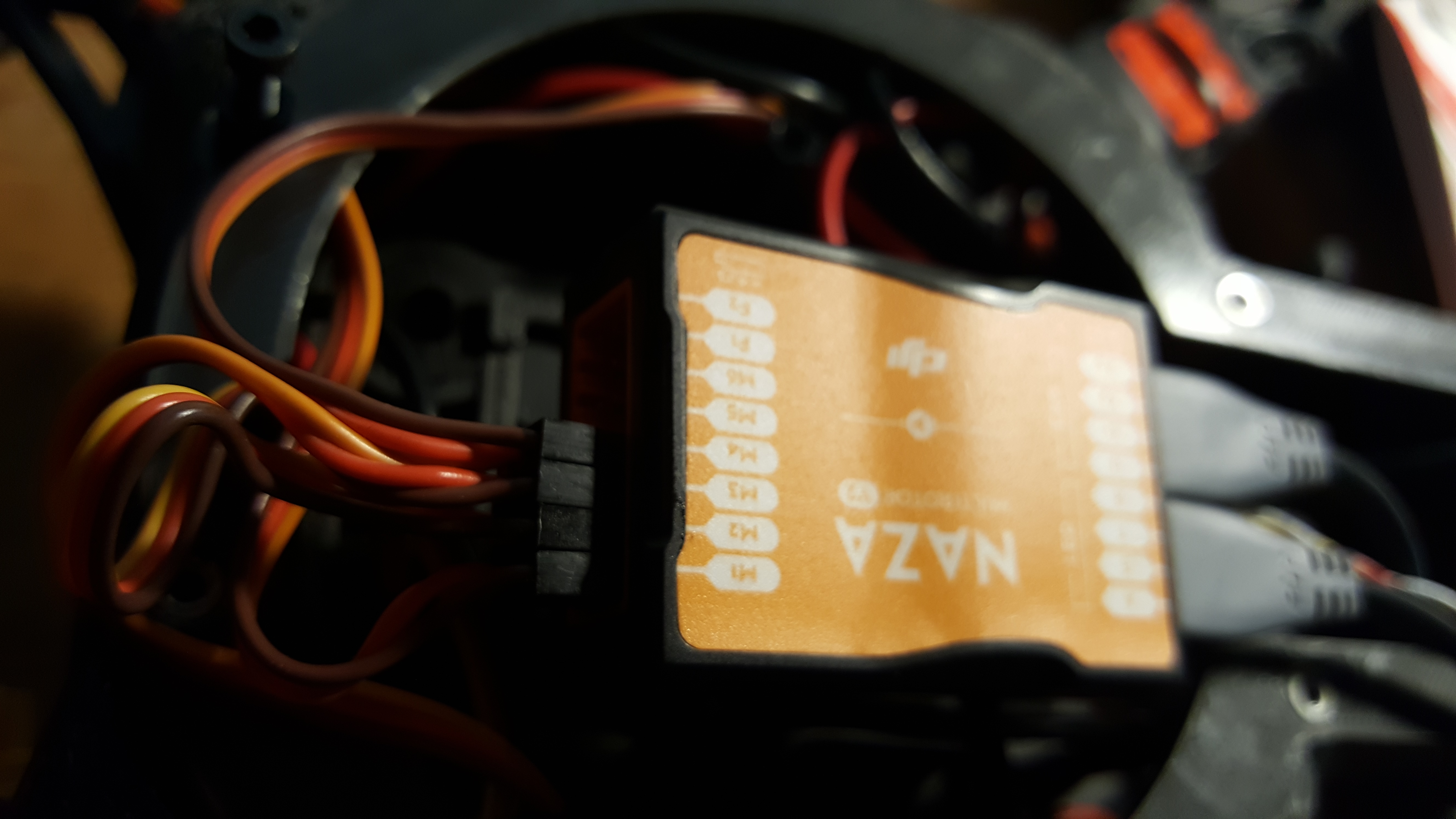

can you post some pics of your setup
I pulled the "guts out because I thought that is what you would want to see
I pulled the "guits" out because that is what I thought you would want to see. 20171021_144423[1].jpg
Motors are on M1 to M4 Receiver is on X2

SO I thought maybe if I didn't use D-bus and ran the individual wires I might be able to get this going. I had to look up how to connect the wires and realized I did not have the wires run correctly for D-bus changed them and the error code is gone. Thank you for your time and help.
