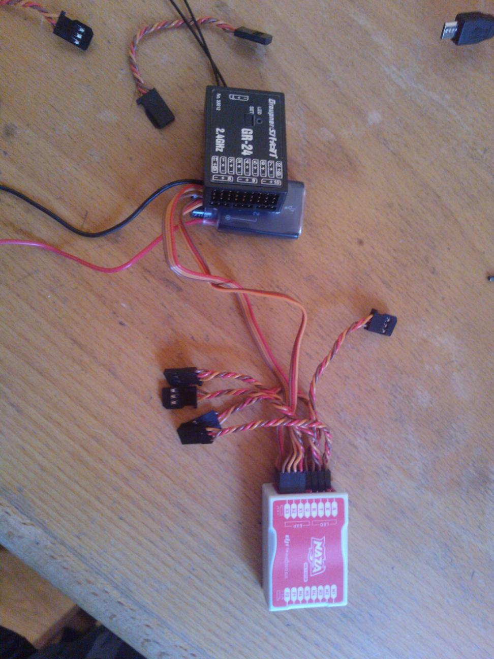

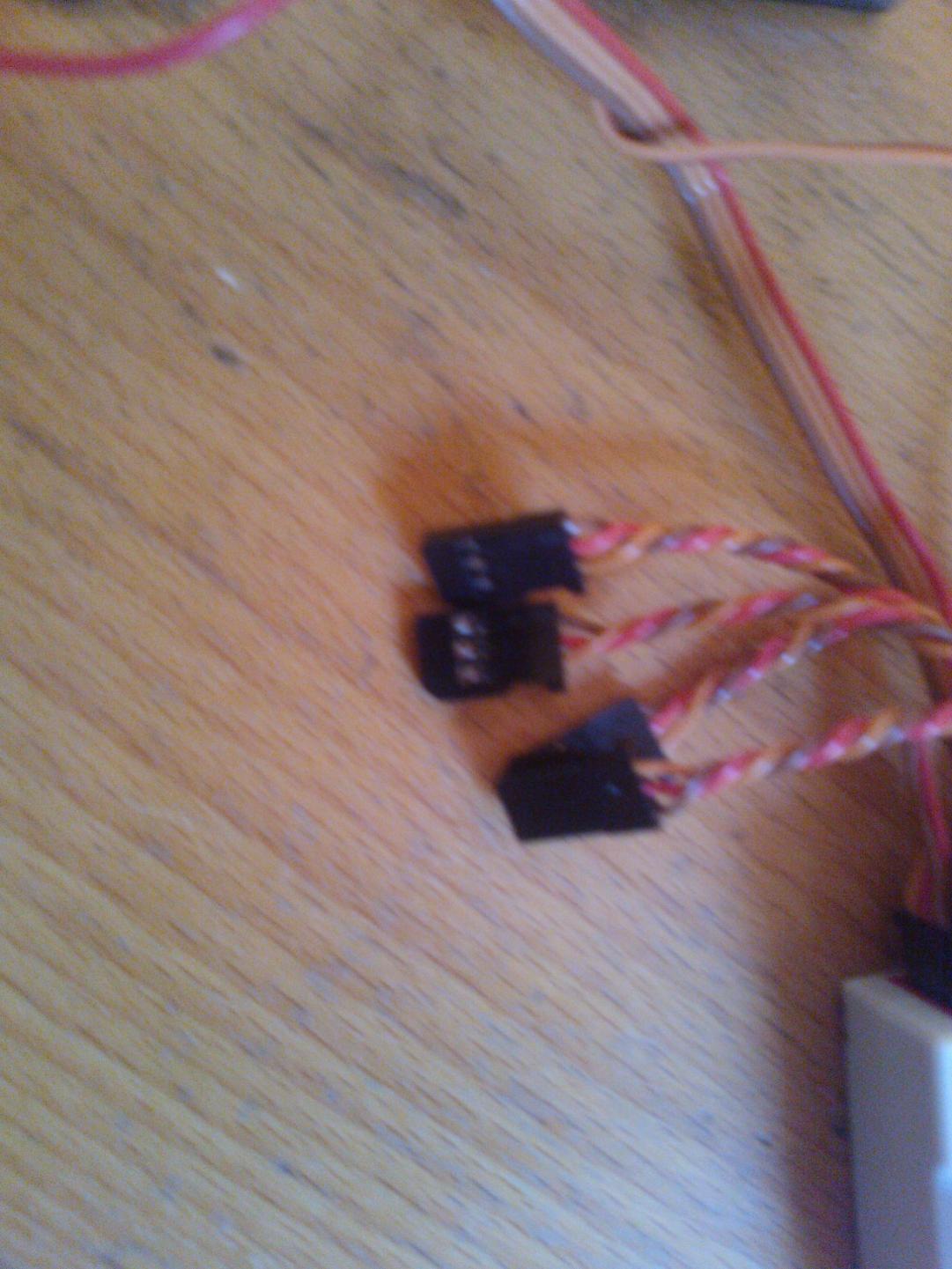

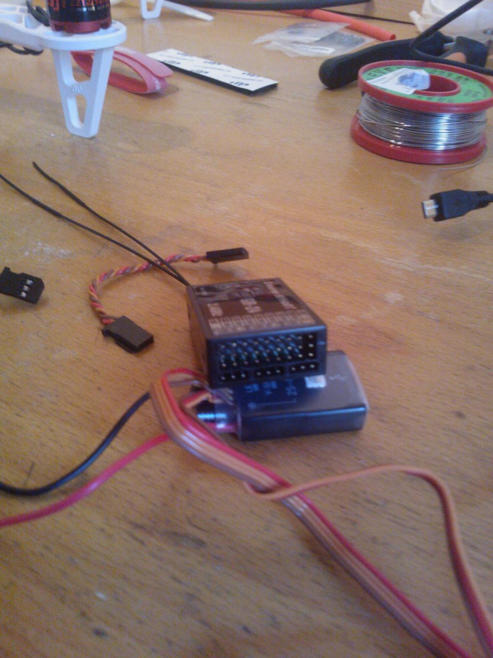

Hello, i´m trying to connect a naza f550 with the mx-20 but i´m probably missing something since the cables that connect the controller and the transmitter don´t fit the transmitter. In all vídeos i´ve seen i never seen someone having trouble with this. Pictures below. View attachment 5895View attachment 5897View attachment 5896

Speedy67
You have to remove the noses from the plugs on receivers side. I used a dremel for it, a cutter will work too...
