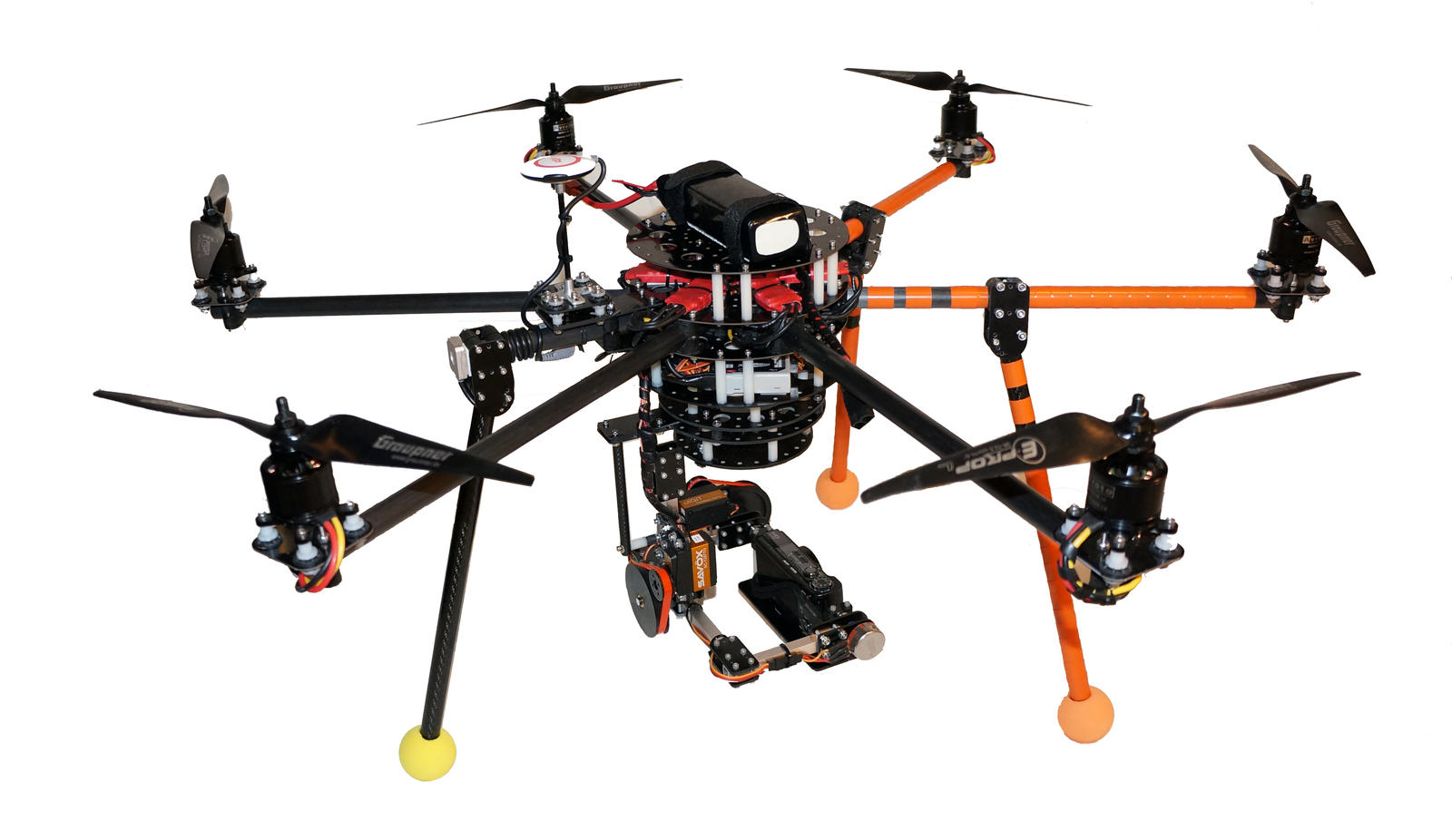

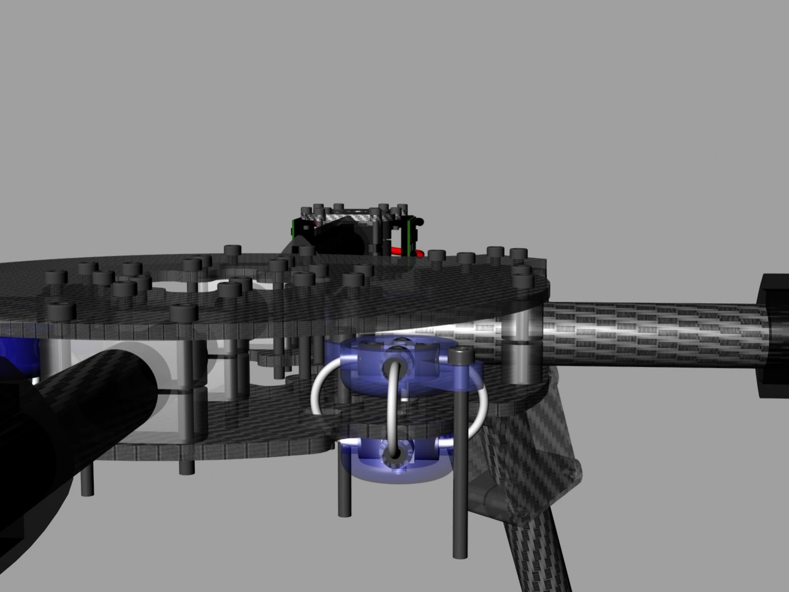

So now that I have redesigned by hexa with the battery on top rather than the bottom, bringing my COG closer in line with my prop plane - should I expect my battery efficiency to increase?
