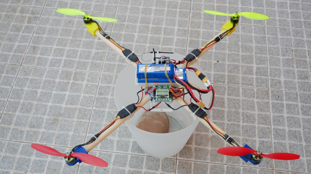

My first custom quad build, 3D printed frame, one of the cheapest possible
CocasDaNeve
Hello, this is my intro on this forum, I broke the frame of my learning platform (a fiber reinfoced turnigy 45cm frame), so I decided to make one myself keeping the cost as low as possible. I also wanted a large, stable frame, I don't need agility yet.
In the end I also made a rubber-suspended camera mount.
I documented the build in case other newbies want to do something similar:
