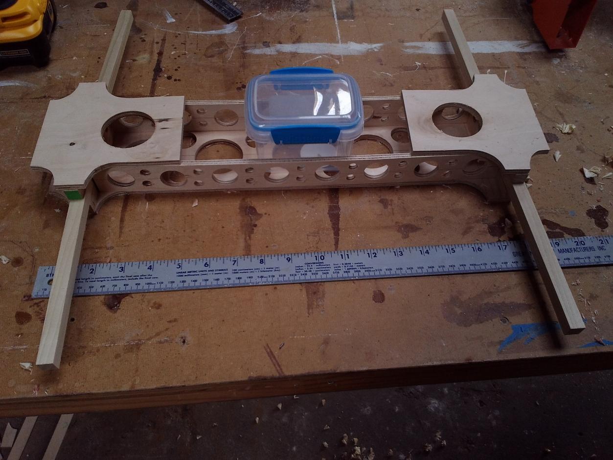

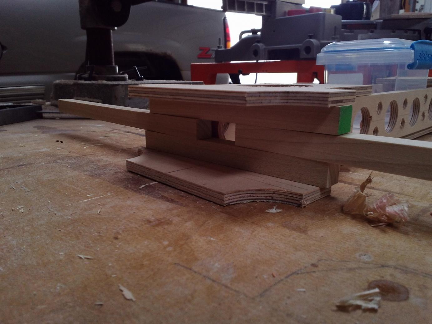

Cut all the parts for my frame.
The food container is a waterproof housing for all electronics and will be vented with a Gore vent which is waterproof for pressure equalizing to let the barometer work. I'm thinking this'll also take care of propwash.
The frame is based on the plans from Flitetest with my own twists. I used 1/4 underlayment for the plywood. I had some inky shop audits very firm and solid with no voids between plys. Ill probably drill some more holes to further reduce weight.
I want the main body be very solid and have the arms be weak breakaway points that are easily replaced in minutes the field. I also plan to attachable motors with zipties for more breakaway protection of props and motors.
