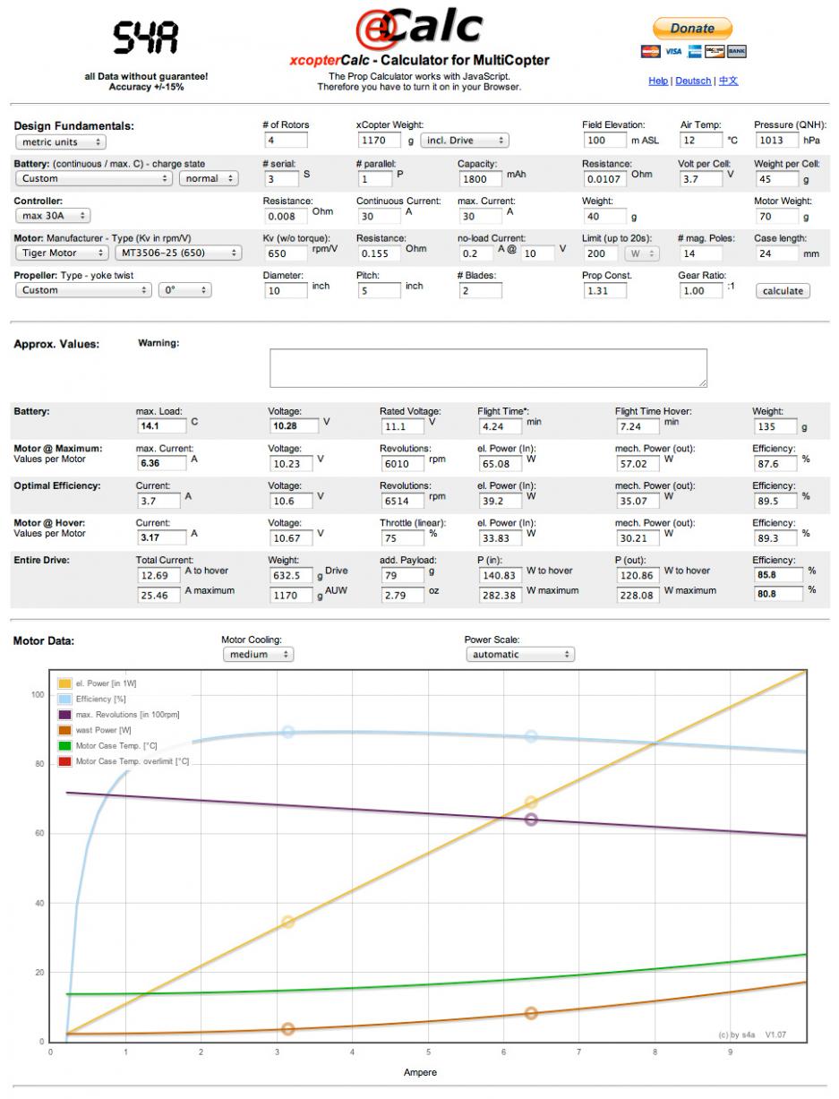

As an aside, i just ran my set-up through the xcopterecalc webpage. There's next to no difference in set-up between the WKM and Naza the WKM weighs 1170g and the Naza 1130g.
Could anyone offer an analysis of the result as it doesn't mean much to me other than thinking >85% efficiency can't be all bad.
