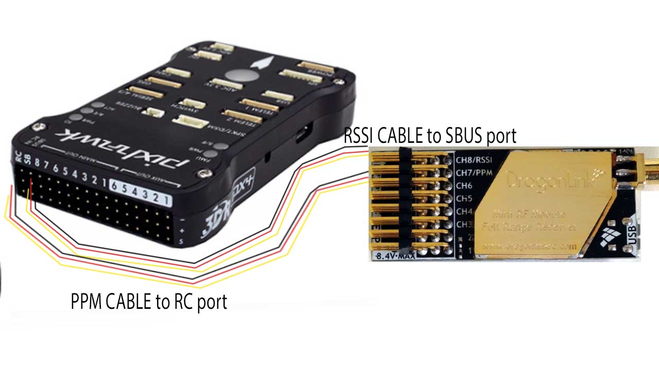

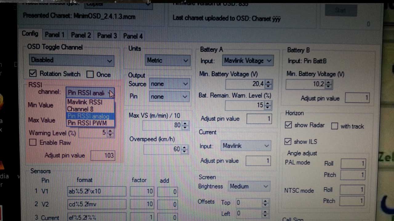

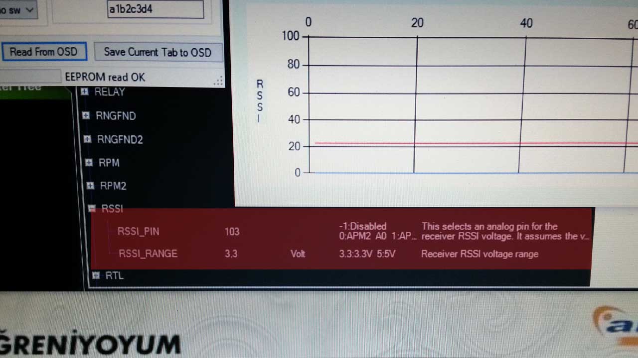

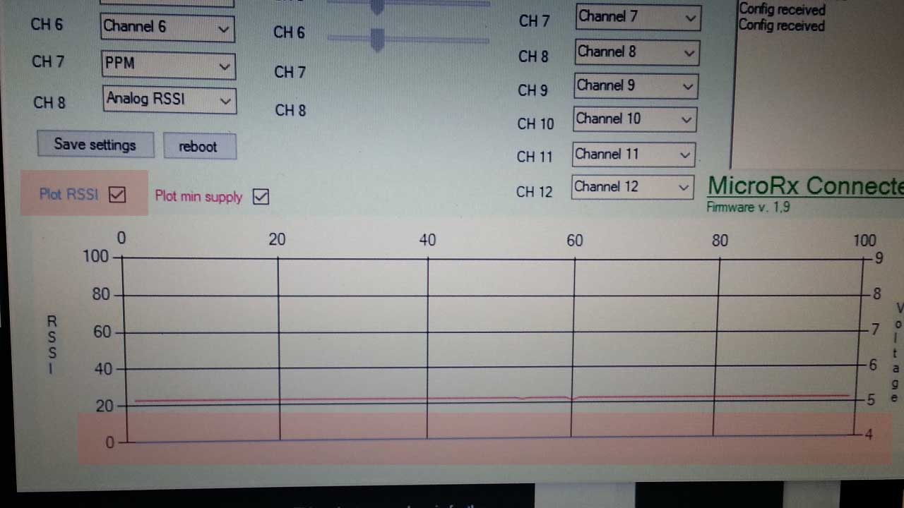

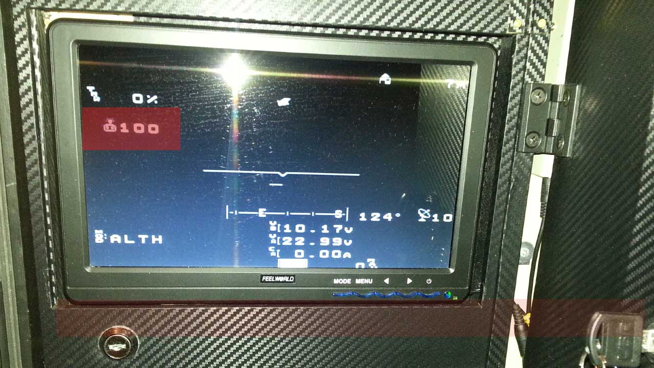

Hi again. I have a question. Sorry for my bad english. I have dragon V2 micro rx and 3DR minimosd. I want to see RSSI value on my ground station.I did connection and setup but I dont know is it correct. I did TX on and off but RSSI value same value. What is the problem. I connected micro rx (photo 1) rssi to pixhawk SBUS port pin 103 ant PPM to pixhawk rc port. Than I selected (photo 2) channel 7 PPM and channel 8 Analog RSSI on Dragon screen. Than, I changed paramater on MP (photo 3). Than I selected pin RSSI analog (photo 4) and I changed min value 1100 max 1900 value, analog pin 103 on minimosd screen. I saw RSSI value 100 on my ground station (photo 5). You can see all screen (photo 6) Nots: Dragon screen (photo 2) RSSI value scale (0). I attach photos my setup. What is the problem Help plaese, Thanks again..
