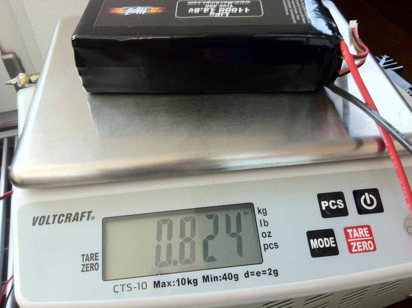

did a couple test with the maxamp 11Ah lipo and up to now i am not dissapointed:
The 820 g to beginn with are true:

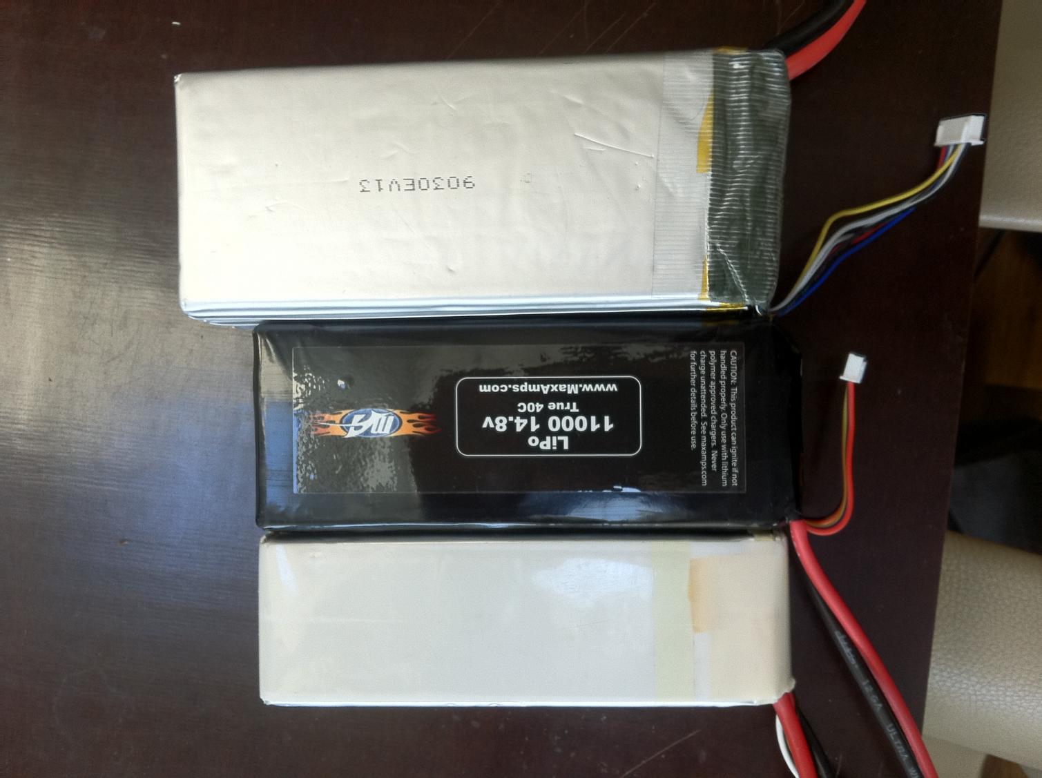

next to a 5000 mAh 5s nano-tecg lipo and a 6s 8000 mAh zippy

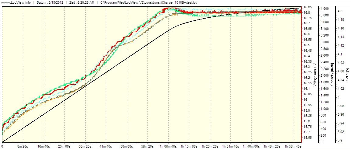

Initial charge from 3.8* something per volt, getting in another 4000 mAh,

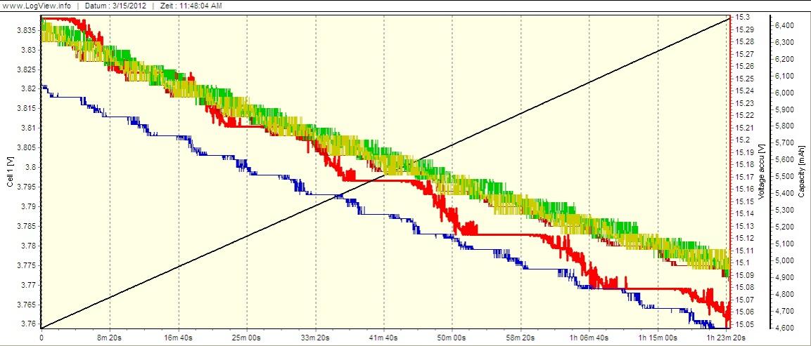

Discharge at 1.2 A, Windows logged me out after 2 hours so i started logging in between again. But i think the main info is there.
Hope i can put it to a on copter test soon with some data from unilog. The only thing i am not happy about is one of the cells, Cell 2 lagging behind hmm lets see

Hi Boris,
I had the same with one cell on both of mine, but after a few flights it was gone.

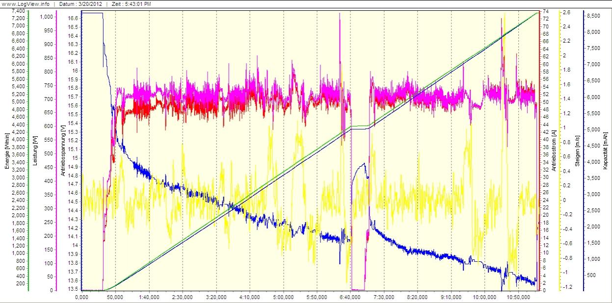

test today with 11Ah CS 8 5.1 KG GH2 12 x 3.8 props on
And if the table ever upload to my webserver some more data in detail, sorry about the german but i think you will understand the data.
Boirs
Ah finally :) http://sprealinvest.at/11Ah.html

they hold what they promise capacity wise. I haven't made up my mind yet concerning the price and if for my flying the extra 3 4 min make sense. Other thing I cant make a statement about if the 300 cycles are really given and what happens if not. I am a hobbyist and not a pro AP guy and dont make my cash on shooting footage, so I will probably once some copter dedicated cash is available again order 2 to 3 more. N

@ Boris,
nice test, haven`t had the time to do my own, but it will come.
