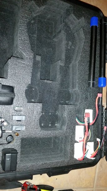

Hello all!
Quick background: We are located in Europe and are prototyping designs for a ready-to-fly Drone/quadcopter. We have the equipment and expertise in this field to manufacture a professional product so we pose the question to you: What do you want to see from us in 2015?
This year we witnessed many crowd funded drone campaigns with all sorts of features and gimmicks. So for 2015 we have set out to make THE BEST, most reliable drone for under < £799.
We want to create a stable aerial photography platform that can carry a wide range of cameras...
Our market is aimed at those who want something more affordable than an "Inspire 1" or "Steadidrone flare" but with similar functionality and that just works.
There seem to be very few 'Prosumer' manufacturers located inside of the EU (Europe) offering complete RTF Drones.
Our product is currently based around the Pixhawk and APM software ecosystem and we have gone to great lengths to tune and program all of the features to work together flawlessly in one professional package.
Here is a preview of the specs:
1Kg Payload
20 minute Flight times – 4000mah 4S battery
Our target price is £799 for a fully ready to fly drone..
Autopilot - Pixhawk + ublox GPS from 3D Robotics
Frame - X650 carbon Fiber
Motors - 710kv
Props – 12" balanced Carbon Fiber
4-in-1 ESC
Turnigy 9XR Radio system (completely set up)
My question to you is this: What features would you like to see in a £799 Drone? Feel free to think outside of the box!
We want to put an emphases on great customer support and documentation. We are in the process of developing our site and are eager to hear your opinions on what you would like to see in 2015!
Here are some pics of our early prototype...

I assume the 20 min flight time is without the 1 kg payload.
I don't see any gimbal in the specs. Is that something that will come on top of the £799 for the airframe?

Thank you for taking the time to reply! We should have been more clear on that point, you are correct, that flight time is WITHOUT a payload. Our prototype is compatible with any 4S batteries that has an XT60 connector, so with a 6000mah battery we are looking at even better flight times!
As for a Gimbal, we are looking at integrating the DYS Smart3 Gimbal, for GoPro users, at least. The price for this integration has not been finalized and we are still discussing terms with our suppliers.

That's a nice looking prototype. Great to see you are using the Pixhawk for the FC. I would want self tightening props so they are easy to install and remove. It's becoming a crowded market so I'm not sure what you can do to stand out feature wise but best of luck.

Is that a frame that is already available from other companies? If so, I would ry to design something that is your own.
Also the props you are using are 2 generations back. Go with 3 hole mounts or folding props.
20 min with a go pro gimbal is accessible by pretty much anyone now, if you want to stand out you should be trying for 50 - 60 minutes with a 6S battery and a 300 - 400KV motor and 15 - 18" props.
Just trying to be honest, if that rig came out today, it's already outdated,

SleepyC is bang on. Added to that, I would also say being portable would be a real differentiator, like what Steadi drone offers. Also, I would love to get some type of optical sensor to complement the gps. People like Steadi drone or Spyder offer something different. Inspire 1 is also trying to offer a differentiation. Otherwise you can get what you are putting together directly from a Chinese web site for a lesser price. Good luck with your development and hopefully you will make something different!

Set up with 6s and 8000mAH, 14" 3 blade folders, two Vtx or a one Vtx with a video switch and OSD dialed into/through the Pixhawk, with motors and ESC's done right flight time should instantly jump to ~49 minutes/ The slow flyer props gotta go.

@dazzab, thanks! We chose the Pixhawk because we believe that 3D Robotics is at the cutting edge of drone tech. Unfortunately it is not always as visible as it should be, but they are building a solid and mature platform and a currently unparalleled software ecosystem and community!
Regarding prop nuts, we use Nylon lock tight nuts which are extremely secure however we are open to self tightening props. Unfortunately there are not many that are compatible with our prototype but we are looking into it.
@SleepyC thanks for this important info. This frame is the 'X650' folding frame. We chose it because it is extremely light and strong. The basic design is not overly complex and performs remarkably well.
One thing that we would like to emphasize is that we 'sand balance' and seal all of our props in house. As stated however, we will definitely look into alternative propeller mounting.
@Shelipso, thanks for the response. Optical flow is very close to full integration with the APM project and this is something that we are eager to include. We want to make sure that the technology is ready and stable therefore we need to carry out more tests.
@Old Man, that would indeed be an incredible machine! We are looking into a 6S power system for future upgrades and are eager to do more tests!

Is that prototype not an Xaircraft 650? Looks exactly like it.

@IrisAerial, for this prototype we have used the X650 frame, it is very close to the ideal frame for our design and fits the criteria.
