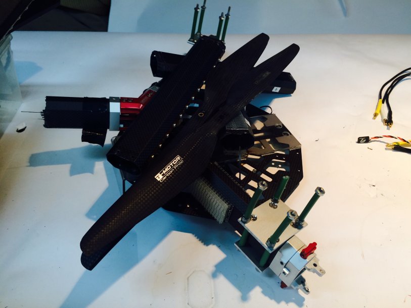

Kde motors and esc. To be honest they ran perfectly and not a mark on them. Lol. No video. Here is the wreckage pile. The funny thing is I'm one of those guys that never gets upset with things like this or car accidents etc. I didn't even swear. Lol.
I'm gonna chill a couple days and regroup. If anyone wants to see the iosd flight data pm me your email.

SamaraMedia
Oh man, that sucks! Sorry to here, glad you can control your emotions like that, you put so much effort in building that thing to have this happen on your second test flight.
Shelipso
Sorry to hear that. Did it flip? Was it like a quick oscillatory motion that you tried to counter it causing the crash? Asking this because your video looks like motors outputs are too powerful for the weight and it was oscillating on your correction inputs (high atti gains).
