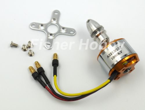

1000KV Outrunner X525 Brushless motors / 48g x 4 = 192 grams

and based on the search that I've made ( still feel like i know nothing) . my Motor/prop/bat combo would give me 2.5 kg and i hope i am rightView attachment 23889

It seems you should be able to lift the the quad with the specs i could find on that motor. you want to ideally have the thrust to achieve your full weight at 50% throttle, which seems like these motors will be close.

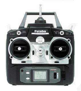

I managed to salvage this Futaba T6EXP . sadly without it's receiver .
what are the possible ways to bind it to a receiver. ( can it be a different model or different brand OR can it be a different number of channels like say 4 or 8) View attachment 23972 View attachment 23973

HERE is the manual. That should get you started. I'm pretty sure you're wandering into a much older technology. Perhaps you should contract futaba directly and see what they say, in terms of compatible receivers. I'm afraid you may be back in hard to find, waiting for shipping territory now.
