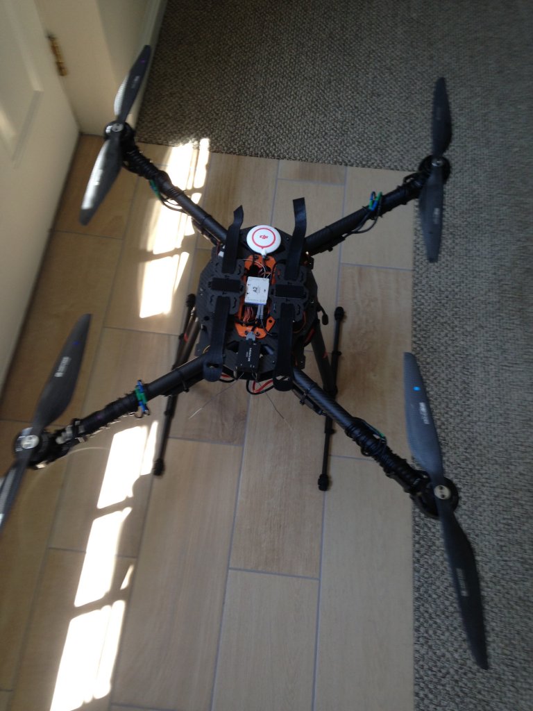

I have a machine that I built using a modified Tarot T18. It has T motor U7 v2.0 420kv motors, 18 in CF props, and T80A ESCs. It's a quad x configuration. The controller is a DJI A2. I can only get 20 minutes of flight time using a 22000mah battery and I'm wondering if that's good or if I should be doing better.
Based on the specs of the foxtech, I'm guessing that the 170kv motors and props are making the difference to get 50 minutes flight time. If I order a new frame, new motors, escs, and 28 inch props I should expect similar results?

Yes, long flight times mean you need large slow-turning motors and huge props for sure. These machines are "floaters" though too, so you need to understand the trade-offs. They don't handle very well, say in a wind etc.

Good point about being a floater and not handling very well. I feel like I'm still at the mercy of the current battery technology.

Our quad that crossed the English Channel in February 2016 can fly for 1 hour 50 mins at 9 m/s forward flight. As already mentioned though, beware of the trade offs this involves, the 'real world' capabilities of this aircraft were severely compromised to get this level of performance. If you really want something to work well in every day use, don't expect or aim for much more than 30 mins no matter what size or spec your aircraft is. The laws of physics are the same for all, and so are the factors that govern the performance of every drone out there. Long flight times ALWAYS mean a compromise somewhere in the system so don't be fooled by manufacturer claims that appear to exceed the norm. The question is whether you fully understand and can live with the compromise you'll need to make for those extra minutes.....
