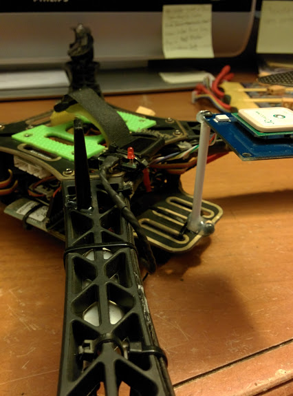

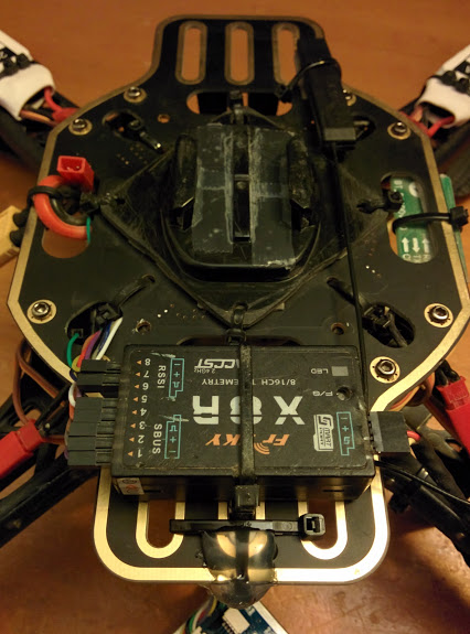

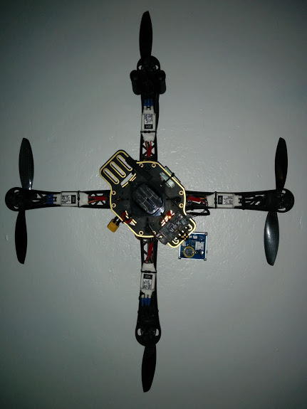

The build is coming together very nicely! I am taking it in small steps as I usually don't have large blocks of time to allot. I have soldered all my IC board connections, including hard soldering my XT60 connector to the board, and 7 Male JST connector whips. I figure 4 for motors, 2 for rear LEDS and one for my Video TX. I also have an inline XT60 with a female JST connector if there is something I missed.
I also got creative with mounting my MultiWii Pro EZ Mega Black and my X8R receiver. I used 2 pieces of thick foam with one side adhesive applied to the IC board (Cut to fit the bottom of my FC), and then I used 4 small zip-ties to mount the FC securely to the foam. I will need to take a level to it, and see if I need to adjust any of the ties to get it perfectly flat with the IC board, but this should be fairly simple. Then I flipped my board over, and saw there was a round spot of sticky foam peering through the center hole of my IC board, so I decided that would be a nice place for my X8R Receiver to go since it is just the right height for ground clearance under the body with the stock legs. Armed with some much thinner grey double sided foam tape (that industrial stuff), I filled the gap in the hole with a small piece, then applied a piece sized to fit the bottom of the X8R to the bottom, and stuck it nicely on the bottom of my IC board, covering the hole. I'll run the RX EZ connector back to my MWP, along with my other EZ connectors for Bluetooth and GPS.
My next mission is to mount the GPS and Bluetooth securely. Finally I will mock up all my FPV gear and see how I feel about my CG distribution when it comes time for batteries.
You can check out all the pictures at the link in my above post or below, I'll keep adding them throughout the rest of my build and testing.

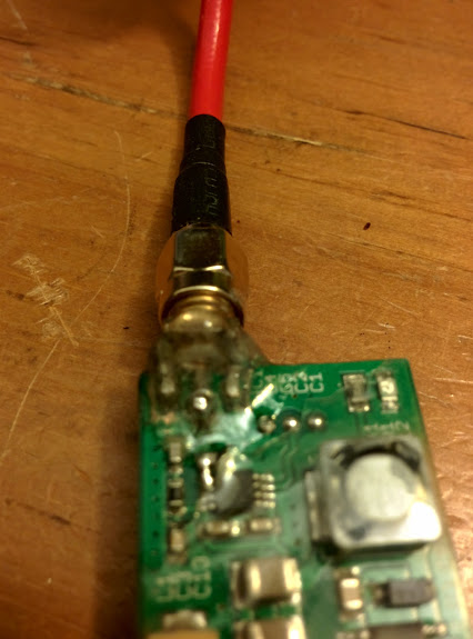

Looking good so far!
Do you have any recommendations for covering my solder patches? Is silicone acceptable, or should I spring for liquid electrical tape?
Also, I want to know if my battery is above my GPS at all, will that kill my sat signal? I am considering mounding my GPS to the back plate extension, but my big 4500 may cover some of it when I place it on top.. Will this be a big issue?

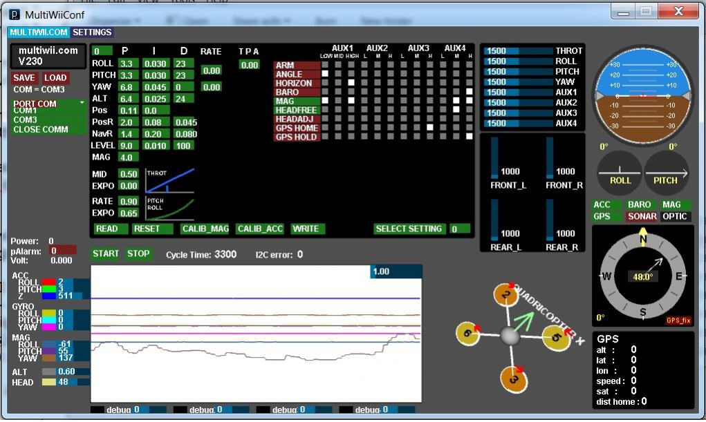

I did find that my propeller nuts on my CCW motors wanted to loosen quite easily. Can anyone tell me if there are supposed to be CCW adapters for 2 of my motors, or if I just need to tighten the top nuts a little more on those motors?
Second question: If I wanted to increase a rate, for let's say my rudder, and I want it to apply to every mode and channel, what would be the best way to do that? I have been messing around in the Companion9x mixes, and have only found ways to decrease the weight of throws, not add over 100%. I am sure I am making it more difficult than it needs to be.
It would be a huge help if someone who has MultiWii 2.3 and Companion9x running on quadcopter could share their eeprom with me, or let me see their mixes page so I will have a better idea of how to program all my desired modes. I would also really love to see someone's MultiWii 2.3 GUI with their flight mode setup, for comparison.
I will give a brief description of how I want my setup to be ultimately, maybe someone with more experience could guide me in C9X to make this happen:
Flight mode switch (SG 3 pos): Low - Attitude auto level / Mid - Acro / High - Horizon *If possible, I'd like just Attitude mode to have dumbed down stick inputs, like a beginner mode for the most stable flights. (75% weights?)
Second Flight mode switch (SE 3 pos): Low - Nothing (just mag I suppose?) / Mid - Headfree (for giggles) / High - GPS ALT Hold
Return to Home / Failsafe (SF 2 pos): Low - Nothing / High - Return to Home (Launch)
I would also like RTH to be activated if my Transmitter is powered off.
Here is a screen capture of my current MultiWii 2.3 setup. Channel 6 did not want to play nice for me, so I used 7 and 8 for modes. Sats connected right after I took the screen cap :)
Thank you for the feedback and support!

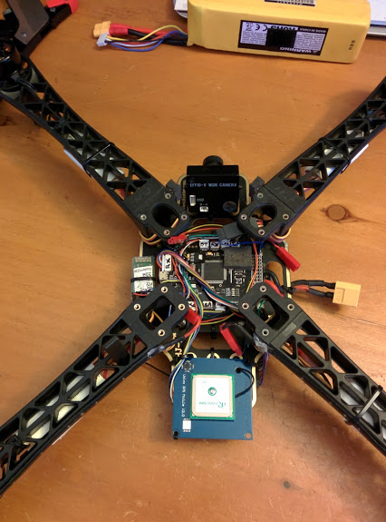

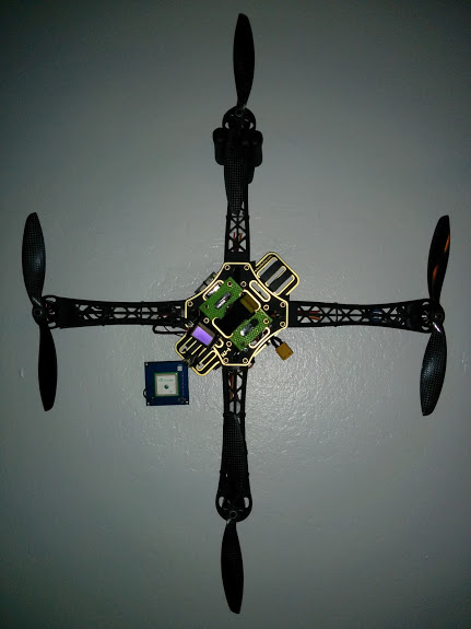

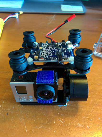

Build Update!
Ok fellas, time for a major build update! Here is my up to date build sheet, with parts and research links: https://docs.google.com/spreadsheets/d/1qEV0lTbWkm7wlAUKEOVeXszXyfQaslDTPBFDIrf95lc/edit#gid=0
I have almost ironed out everything on the Night Ninja, including GPS extension and a removable gimbal/leg solution. My battery collection is growing, as is my flight time behind the sticks and my YouTube channel is getting a lot of love recently!
I will include what pictures I have and some videos from my recent exploits. I have rebuilt the entire quad a handful of times now, replaced 2 arms, a ton of props, and practically destroyed my Immersion 600mw TX SMA connector. For the time being, my FPV will be on hiatus until I can repair or replace the TX. However unfortunate, this has given me time work on other things like my gimbal setup and GPS mounting. My UBlox 6M is now above all carbon props and flight gear, with a clear 180 degree line of sight to the horizon, which should drastically improve my Sat lock and Position Hold reliability. Still need to do further testing with Return to Home/Failsafe...
attachment.php
attachment.php
attachment.php
attachment.php
attachment.php
attachment.php
attachment.php
attachment.php
The missing channel plug is for the tilt control of my gimbal, and the mount is 3M'd on as well as ziptied. Although I do not have a picture, the GoPro clip portion was easily epoxied onto the upper isolation plate for my gimbal, making it a simple clip on procedure to have perfectly stabilized 4k video, controllable by an App!
