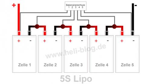

The problem is: Each Lipo pack consists of single cells with 3.7 V each....and each +/- cell got a balancer wire.....
balancing the cells in a LiPo pack is absolutely necessary to bring ALL cells to a given charge level equally.
Most LiPo's you will come across are seriell connected LiPos...eg 2S, 3S, 4S and so on....you will hardly find 3S2P (or similar) LiPos.....
So to my logic: Each cell got a balancer wire and a specific charger is rated for 6S (meaning max. 6 sensors for the LiPo's balancer wires) means I can either hook up a 6S pack or 2x 3S or 3x 2S......otherwise I run out of balancer ports....
I found a thread where a guy explains his parallel charging system, but the way he explains how the different cells balance each other is more than strange.....I personally will definitely stay away from this:
