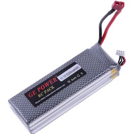

[h=1]GE POWER 11.1V 5200mAh 30C LiPo battery can met your needs as Pete said"The bigger the battery capacity the more it will weigh and the more weight you carry the more power will be used to just get off the ground, it is always a trade off to put a bigger battery on board."[/h]View attachment 16982
