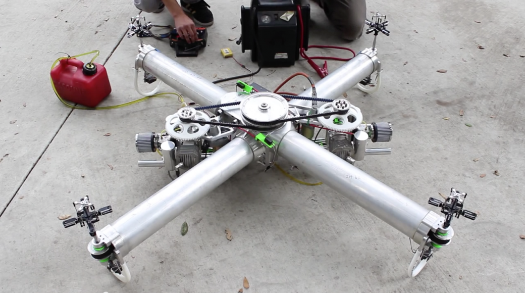

Welcome to the Incredible HLQ project! We are a team of senior mechanical engineering students at San Jose State University developing and building the worlds first Heavy Lift Quadcopter (HLQ) with a practical weight capacity of 50 pounds. This site will follow the progress and status of the project as it proceeds from concept to working prototype. Please check back often for updates and thank you for visiting!
View attachment 21672 View attachment 21673
WHAT IS HLQ?
We are designing and building a Heavy Lift Quadcopter (HLQ) which we are calling Incredible HLQ (sounds like “Hulk”). Like the super hero, HLQ will be able to lift and transport a huge amount of weight for it’s size and cost. HLQ will be capable autonomously retrieving and delivering 50 pounds of payload.
HOW ARE WE DOING IT?
In order to accomplish the 50 pound goal, HLQ will utilize a drive train powered by two gasoline two-stroke engines of about 12.5 HP each. Lift will be achieved using four commercial RC helicopter rotor heads spinning four 435mm blades. Selection of these blades were based of actual lift testing in our test rig which is featured in the video. Control is achieved by using the variable pitch control of the rotor-heads to change the lift output and induces torque of each rotor.
Flight control will utilize DIYDrone’s Ardupilot APM2.5+ module. The Ardupilot is a open-source arduino based control board for UAV’s. It has been widely utilized for many fixed wing, helicopter and multi-rotor flight platforms and has a proven track record. Best of all, the programming is already done for us.
In addition, we will be utilizing a computer vision system for payload identification and tracking using the OpenCV library on a Roboard RB-110. The RB-110 is a complete computer on a single board. It has a 486 compatible processor running at 1GHz and is capable of running, Windows, Linux or Dos. We will be using OpenCV through it’s Python extensions to identify payloads and guide HLQ in for retrieval.
As students of San Jose State, we have a lot of resources available to us for designing and building HLQ. The Engineering department has a computer lab which has design tools such as PTC Creo, Solid Works, and Inventor. We have thus far been utilizing mostly Creo to design and analyze HLQ. We also have access to electronics labs, mechatronics labs, and product testing labs to help build and troubleshoot HLQ.
We are also just two blocks away from the San Jose TechShop which gives us access to lathes, mills, laser cutters, a water-jet machine, electronics equipment and more.
Lastly, but perhaps most importantly, we have made contact with members of the worlds top aerospace and mechanical engineering firms right here in the San Francisco Bay Area. We are designing HLQ with reliance on their knowledge and experience.

Amazing...... I can see the need for variable prop pitch control when the motors are not electric. Wishing you great success.

A pair of 100cc gas engines is going to consume quite a lot of fuel so the tank design and location will be interesting. I would change engine manufacturers for something at this investment level to ones with a strong history of long term dependability. This is what I do for a living (UAV gas engines) and something I have a lot of experience with at the hobby level too. Something will have to be done about engine exhaust because the sound of the props combined with the engine noise will be horrendous.
I'd be scared to rely on a servo to keep it in the sky. The vibrations coming off them motors has to be extreme..... i've seen weird stuff happen in gassers and servos and electronics in general
sounds cool, gonna be a noisy sob by the time it's got 50 lbs under it
four stroke gassers in that size range are starting to catch on so that might be a good avenue for future development
i could see some crazy pilot with goggles hanging out of that thing in the next mad max.... haha
Old Man
Too heavy. That thing as it stands should be able to dead lift a bit over 100 pounds if they prop it right. However, mods to make it less noisy will rob some of the available power. It still won't be as quiet as an electric bird though.

That is EXACTLY what I told them. None of the three guys I met had a lot of practical RC experience. I really hope it works out for them though.

Which engines are they using? I have a gas heli with a Zenoah. Should be very reliable. They are basically just converted commercial motors. Are they using HK motors or something?
Vibrations are a consideration, but should be manageable. Overall, the reliability of these helis systems can be better than multirotors. Remember the technology is very mature. I've seen guys with hundreds of flights on gassers without failure. At that point, they replace components when they wear out, and the wear is usually detectable on inspection, unlike massive ESC FETs. You can't predict when those are going to go.
Old Man
A Zenoah will last forever if cared for half way decent. The engines on the quad look to be Chinese copies of a 3w or MVVS. Most all of the copied designs significantly changed the internal layout of the cylinders to save money on production costs during the sand casting process. The change in design causes them to shorten the life of the piston and ring dramatically. There's also issues with the use of lower grade bearings and carburetors low in reliability. Only one thing keeps the props spinning and you want that to be the best it can be, not the lowest priced.
As for servo reliability, great servos can be had at pretty good prices. As you noted, gas RC guys have been working theirs hard for a good many years. A little periodic maintenance and they keep on going. A well designed installation can permit a good servo to easily perform for a 100 hours or more. And that's in a position directly mounted to a gas engine.
