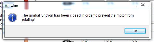

When i go into the custom mixer to setup the Andreas Baier non standard motor mix, the assistant software very cheerfully pops up a box telling me the Gimbal function has been closed to prevent the motor from rotating, the motors on F1 and F2
attachment.php
After entering the custom mixer values for all 8 motors and true to it's word i find the motor test only fires up motors 1-6 but not 7 and 8, this is also true when i do the CSC, motors 1-6 spin up at 100% Throttle (regardless of the TX stick position, which no longer has any bearing on the speed of the motors) and 7 & 8 do not start.

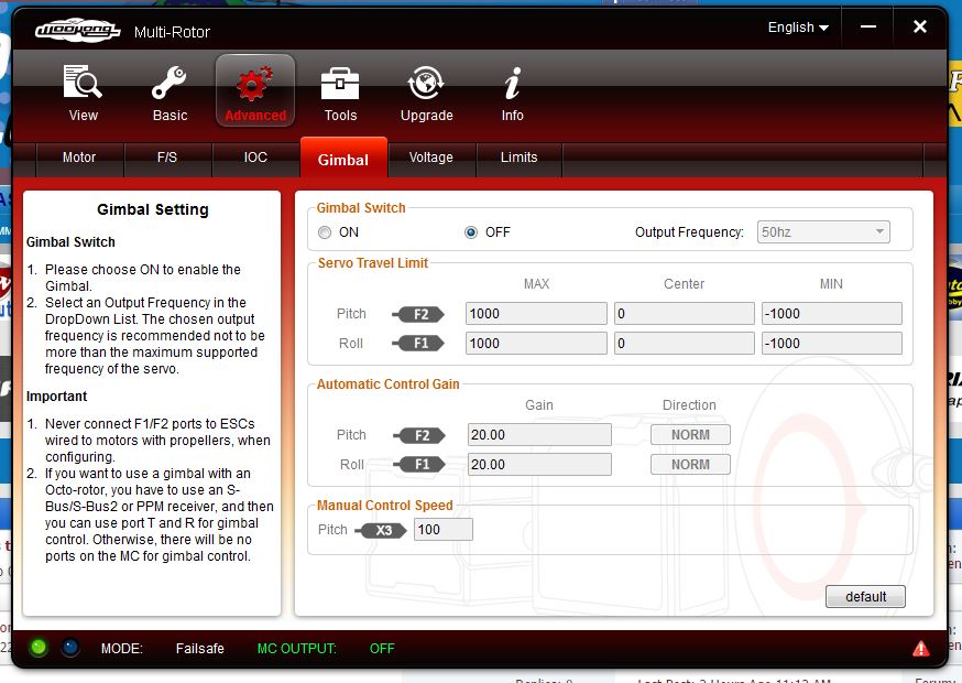

I am using firmware 5.26, the ESC is a Herkules III, the TX a Futaba T14SG set to 14 Channel Fasstest and the receiver a Futaba R7008SB connected to the WKM By S-Bus. I am not using the F1 and F2 WKM Channel for Gimbal control and have that function switched off in the Assistant software.
If i switch on gimbal control Motors 7 and 8 spin up on their own but that bit i understand.
