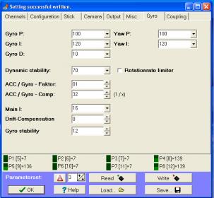

Of course EVERYBODY is stupid some of the time but I cannot find any physical assembly mistakes i.e. clockwise/anticlockwise assignment for the motors and wiring from motors to BL-Ctrl's (verified in KopterTool with the individual motor test facility). The Configuration Setting is the straightforward default 'Beginners' configuration or the same with GPS and Compass disabled (Altitude is already disabled by default).
I have no idea which numbers should be changed within KopterTool to smarten up the Pitch axis performance - remember, the Roll and Yaw axes appear to be relatively stable, it is only the Pitch axis which is so obviously wrong - but then, when I am told here on this forum that the default 'Beginners' configuration is sufficient to permit the MK to get off the ground and keep itself under control, why should anything have to be changed at all?
