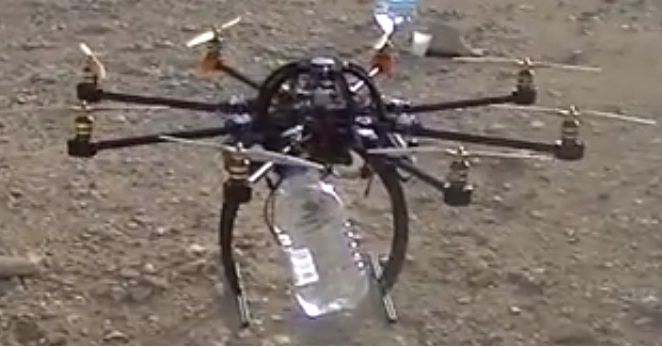

no i'm not from France, and my problem that i want to carry payload about 6-9 KGs for about 15 Minutes, i picked the previous parts, installed them all things is good,
when i tried to set payload about 5 KGs using all the previous parts with (14X5 Propellers & 4 batteries 8000 mah 5s1p) the aircraft can take off very easily when it was in the air after about 1 minutes it give me a second level protection was reached, and it went to landing.
when i check the batteries with my meter, it still have 68% of its capacity,
so tell now i don't now where is my problem to carry payload like 6-9 KGs, is it in the motors i must to replace them, or in batteries or ....

Bird this size and weight it would be better to have a separate telemetry system to have a constant status of your lipo ! You wanna see how much A you are pulling and the behavior of the V.

2826 are not capable off 6kg payload. I mean i would like to know what do you mean by payload. Do you mean the whole kopter weight or payload only. Payload does not include copter + bateries but is payload only.
For 9 kg you need or KW10 or axi 4120 with 15 or 16 inch props.
If you have 6kg or 8kg copter and another 6kg payload on it with 2826 and with 11 inch you are lucky you did not burn motors or esc while flying.
Also get a telemetry since dji protection is not for you. Also you draw too much amps and this is why your voltage drops.
Maximum lift power off axi is 1600g to 2000g per motor tested on scale. If you had 14kg total weight and 8*1600= 12800g=12,8 kg while maximum would be 16kg i think you have more luck then .....
Hope this helped.
http://vimeo.com/53019192
this is the maximum that it could lift. Payload was arround 15kg but sugested payload for this configuration would be 7 to max 9 kg. 4 bateries for 9kg and 16 or 17 inch props.
