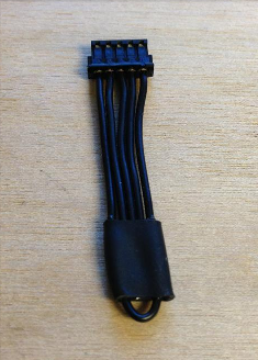

send you a so called jumper plug, which looks like this:
After you get the jumper, follow this procedure to bring your MoVI back to life:
My trouble was: I am sitting in South Africa, didn't want to spend hours with the support guy and didn't want to wait for that damn jumper, so I took the risk and made one myself. Since the whole trick is to connect pin 1 with pin 5 (the other pins are doing nothing during the un-brick process), I took an old balancer cable and fiddled the balancer connector out of the plastic housing. The pins on the MoVI are very thin, so the tiny connectors on the balancer cable are doing the trick....looks like this:
Just make sure they sit firm on the MoVI pins 1 and 5....and make damn sure they are NOT touching the neighboring pins. From there you just watch the un-brick Youtube movie from above.....
