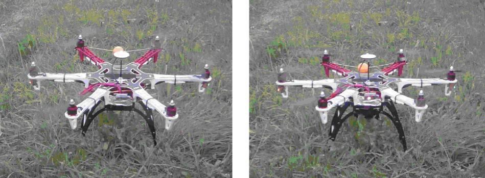

Picture right with no power, left before takeoff (tilt direction camera.

Sorry, I forget to mention this item. Without camera, the center of gravity is in the center. With OptionPro Camera a little bit to the front. But not different in tilting.
And sometimes (verry rare), I'am chocked then, he starts exacly vertical. Verry nice to see that, an so I try to finde the fault.
But in the beginning I used the original F550 (without landing gear, camera, GPS, FPV, ...)
And even there this effect was to see. For the first fligth I corrected this tilting, to much, and made a flip on bottom.
Now I give a hit wiht power and up in the air. There (50 cm) with now contact to the bottem he stabilize without any correction.
As if the electronic (sensors) feels the problem and correct it.
