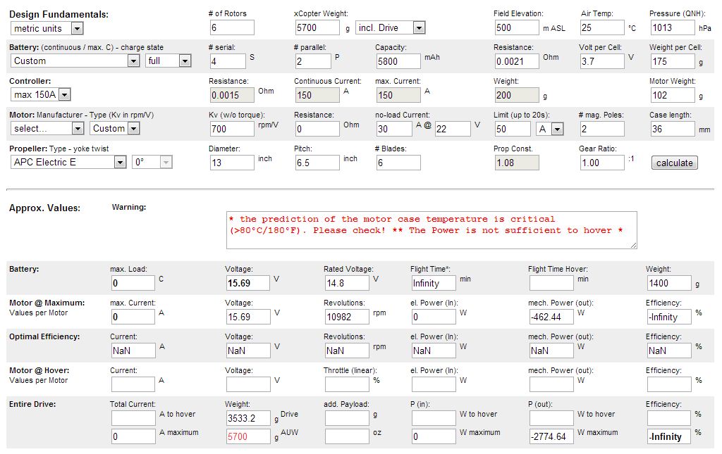

Sorry, completely forgot to reply to you! I've attached a screenshot of the ecalc.
Specs of the multirotor are:
Droidworx AD6 frame
All up weight including everything is 5700g
6x APC ACE 13" 6.5 props
6x Torxpower 3536 heavy lift motors (700kv)
2x 4s 5800mah batteries in parallel
Let me know if you need anymore information.

Anyway, if your running two 5800 mah lipos in parallel then you've got 11600mah. So change that.
Your motor specs are all out. The torxpower 3536 is a tiger motor clone with slight changes. I use them too. Select tiger motor MT2814-11 in ecalc and that will get you as close as damn it.
Hope that helps you out. Might have missed something but can't run ecalc on my phone....

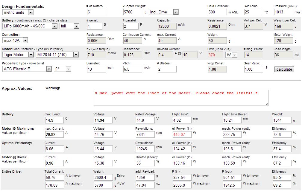

View attachment 6723The Torxpower motors are similar to the Tigers I've selected on the attached. On this basis your MTOM would be 7059g (5700 + 1359) - the mass at which eCalc calculates that you'd need 70% throttle to hover (the safe limit in order to retain headroom for control). However, I'd say that the figure would be better generated from a real-world test with your rig - what maximum weight leaves you able to fly with full control over the aircraft in all conditions (wind, etc.)

Change the motor cooling to good. Your still over the motors limit at full throttle though.
