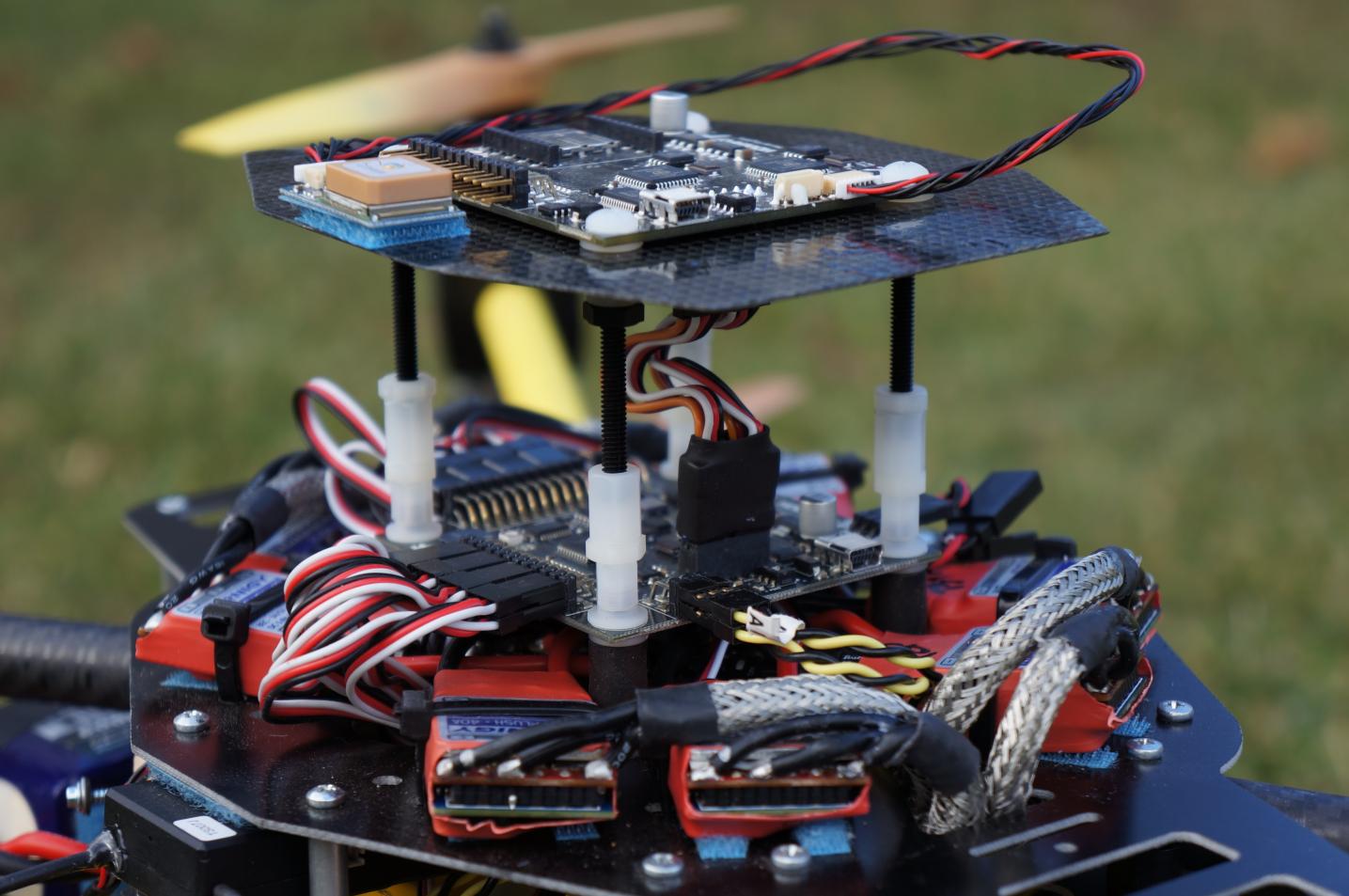

Hi everyone,
I'm trying something different with my Hoverfly GPS installation. In the pics you can see I've elevated the GPS board about 2 1/2" above the PRO board and I'm using four servo wires as a temporary connection between the PRO and the GPS boards. You can also see I've put my motor wires in braided wire wrap from where they exit the CF arms to where they connect to the ESC's.
With the new firmware installed and all the calibrations redone I've got good stable flight and no wandering heading (yaw) issues that were present when the GPS was mounted as designed to the PRO board. SO maybe the elevated GPS board is helping with the magnetic interference issues. Also, the GPS board went to solid green in about 45 seconds after the first power-up with the new firmware.
The problem now is that the heli is wandering around when GPS position hold is engaged.
View attachment 8214View attachment 8215
I'll keep working on it but the elevated position of the GPS board seems to be helping. Any suggestions/comments/opinions?
THanks,
Bart

I've got 2 1/2" standoffs on order to clean things up a bit. :)
Can anyone suggest a source for 12 wire ribbon cable and 2x6 end pieces? The servo connectors prevent the board from being mounted any lower than it currently is.

Bart,
What you are seeing is related to the on-board compass on the HoverflyGPS picking up EMI from your on-board electronics. We have a solution for this.
https://hoverflytech.zendesk.com/entries/22417583-external-compass-magnetometer-v4-6-and-above
Moving your HoverflyGPS board a few inches up is basically the same thing as using an external compass in terms of how it affects this issue.
Your efforts are probably better spent just using the external compass as the results will be the same (with a lot less effort).

thanks for the reply George but I'm trying to keep everything under the dome. If I can get the board to work well at about 2 1/2" then it will fit. What I don't understand is that I'm getting a quick satellite lock and I have no heading/yaw issues like I've had in the recent past. Why would the GPS PH performance still be flaky?
I've seen the external mag modification and the newer GPS board but I've wanted to see about this arrangement before going the other route.
Bart

You could still have compass issues. I would start by re-calibrating your compass. The current version of GPS hold also does not hold a position extremely aggressively, but it should more or less stay in the same position.

just a quick update,
I removed the carbon fiber plate from between the GPS and the PRO and it didn't make a difference. The GPS is still mounted on 2" stand-offs above the PRO and that seems to be what is making a difference in addition to bundling the wires more closely together. I also need to admit I had the GPS antenna plugged into the wrong socket on the GPS board so I'll have a better test tomorrow when I'm out flying. The heading glitching disappeared with the extended stand-offs though so there's hope.
Bart

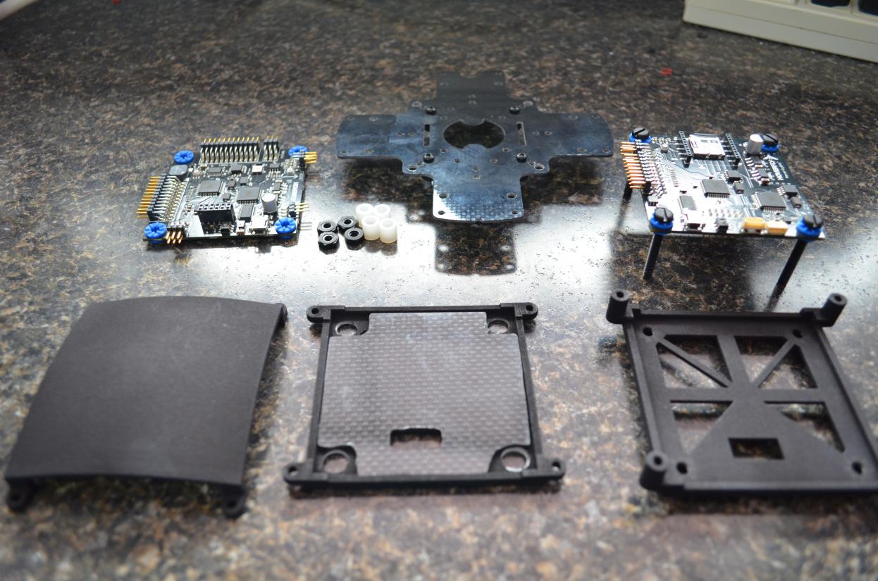

I'd like to know your resluts. Here are few images of what I've got done.
Haven't tested yet as the Hex is current in the build process, shouldn't be too much longer.
When it was in the quad config without the carbon fiber plate, I wasn't impressed with the gps hold.
I've since gotten the Mediatek v2 GPS to go along with the build so ... figures crossed.
View attachment 8931 View attachment 8932
