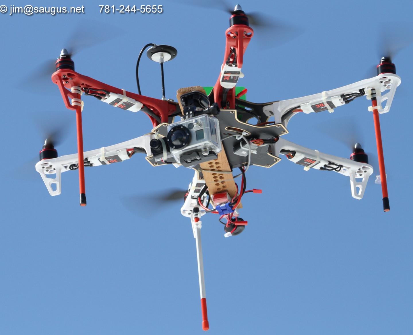

I built my DJI F550. Toughest part was soldering for me. Programming the NAZA via the NAZA assistant software was fairly easy. There are many video's on the net about building and setting NAZA via USB.
A 450 may give longer flight times VS a 550 will have more lifting power. I'm more into still photos than video. Either way video and photos from an unstabilized camera mount will be less than perfect. Most of my aerial photos need lots of color correction, distortion correction and the horizon leveled. I use a rigid camera mount. View attachment 11639
BTW, I highly recommend the GPS module. It makes flying easier as the GPS facilitates position hold. The GPS return to home feature has saved my craft from getting lost, TWICE!
I use a Spectrum DX8 and range is beyond 1/2 mile.
