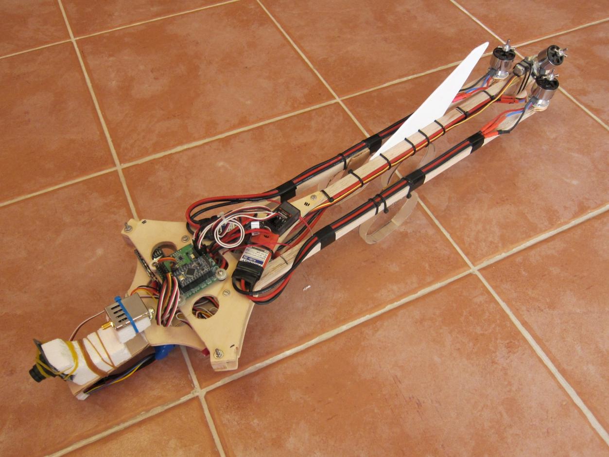

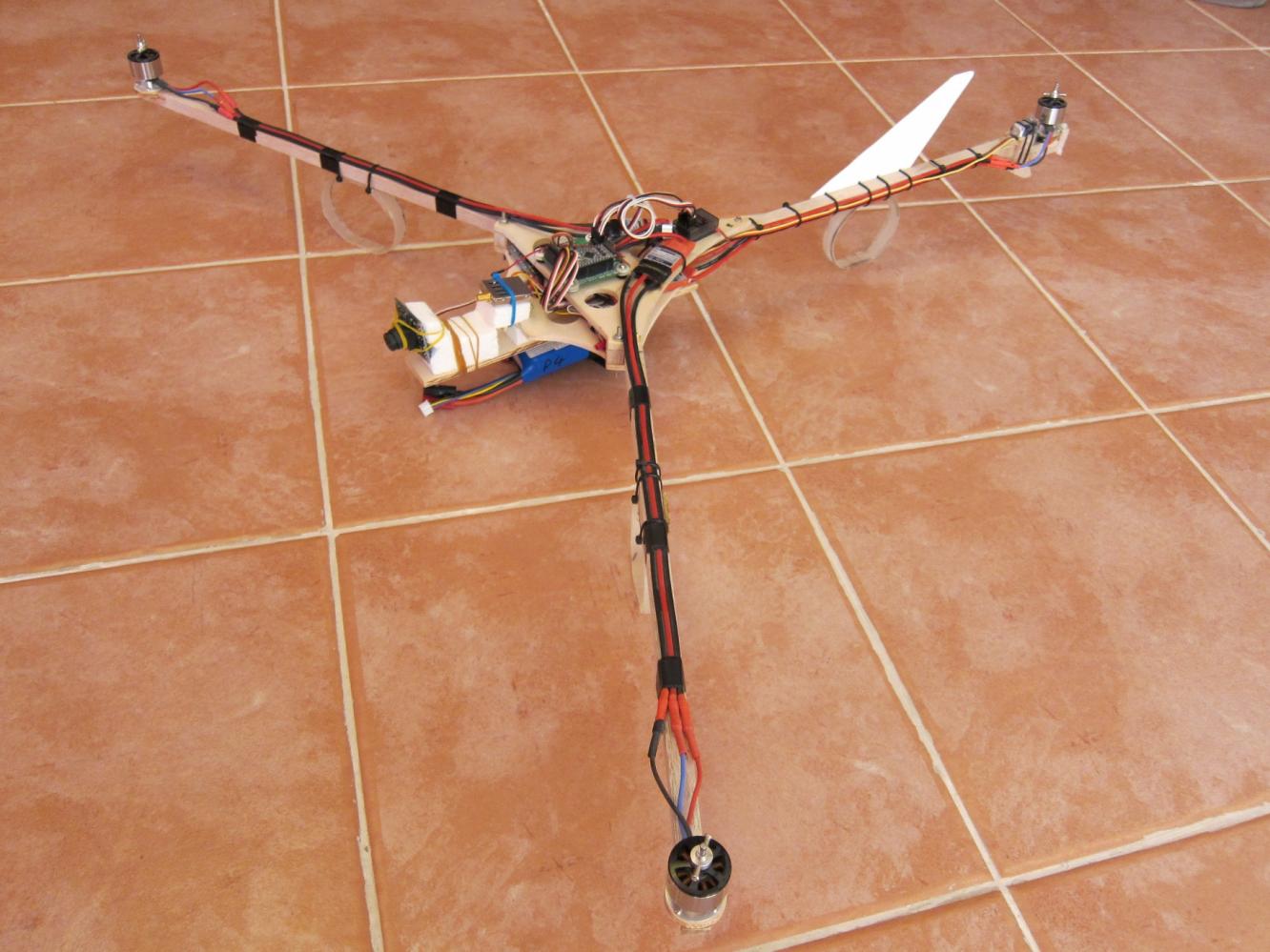

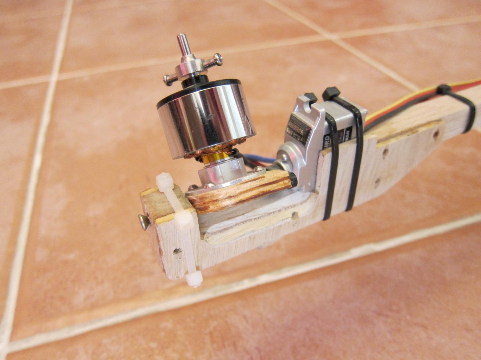

I am currently experimenting with a Home Built Tri and MultiWii system
The pictures are of its current incarnation but its just about to under go a big revamp with new frames and a much better FPV set up.:cool:

HI Ben.. you in Qatar doing oil work? I have some buddies over there... I hear its pretty hot. Cool photos of your home made tri machine. Does that back prop clear the rudder like that or maybe its set up different when you fly it? DO you have any video of your machine flying.. I have never seen video of one with tail servo.

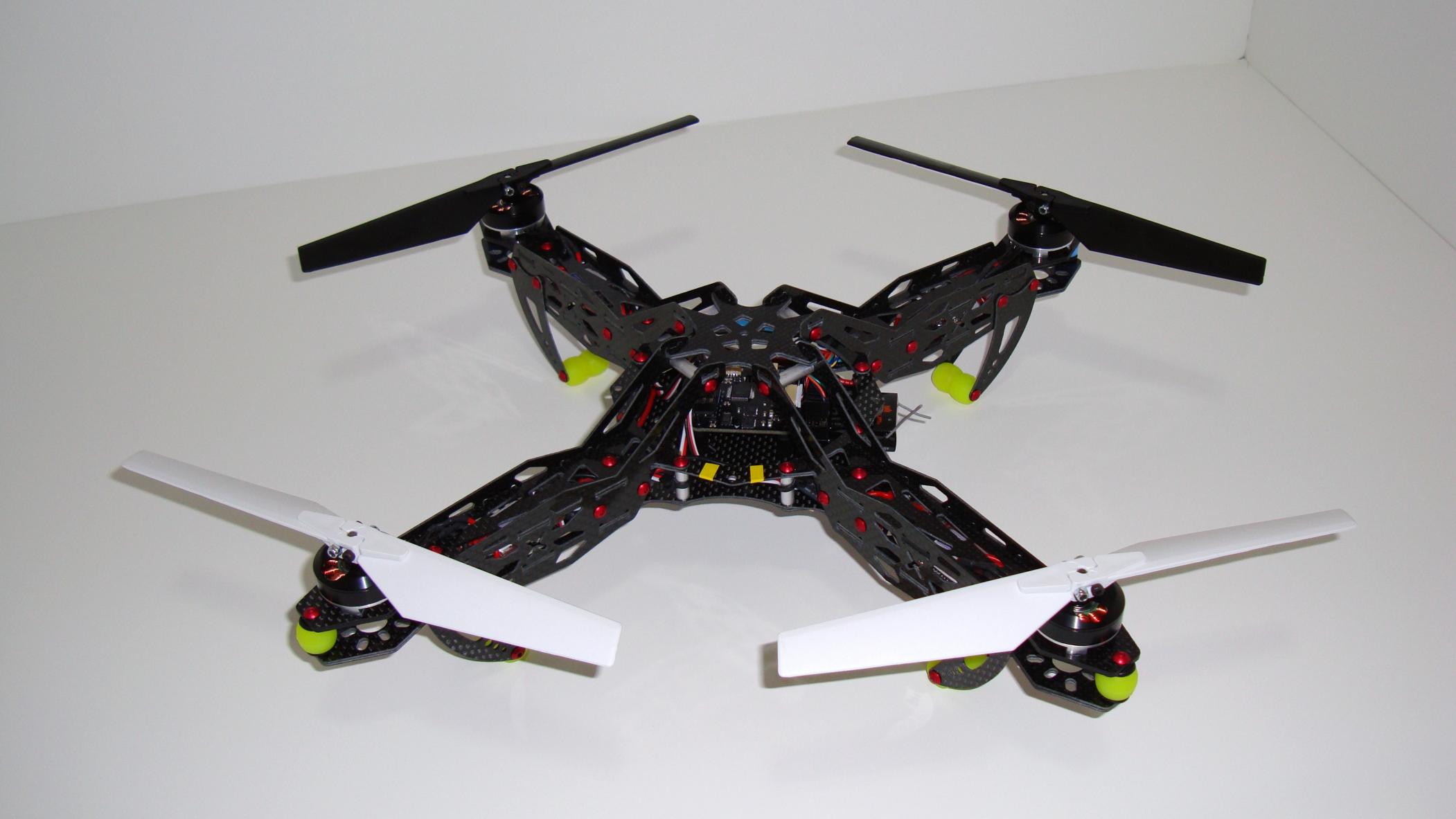

I have Built a Few Multicopters with the Copter Control Board with very Good Results.
I have a Big thread on the OpenPilot Forum as well about my Build of my Karbonic-X CF Multicopter Frame.
Flies Awesome!
You will like the CC FC For Sure.

Regarindg the Tail on my Tri. The Rudder as you described it is just a fixed vertical fin for visual reference rather than a working rudder.
The servo tilts the rear motor to vector teh thrust in teh opposite direction to the way you want to yaw.
It works very well and has good authority. I must add that that deisgn has been around ages and is not all my own work!
