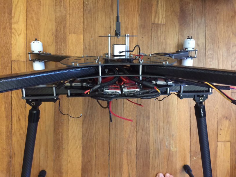

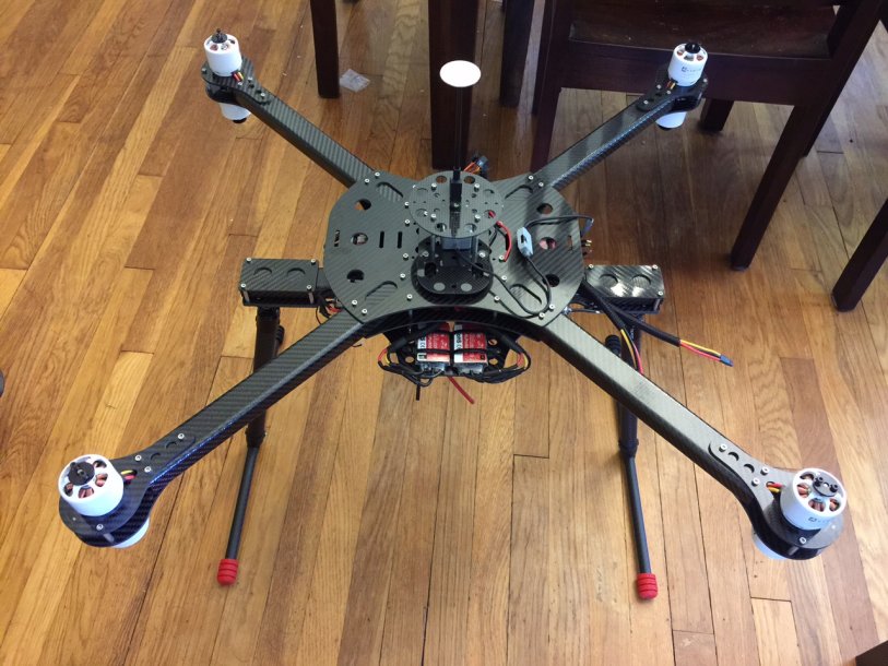

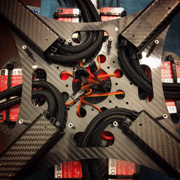

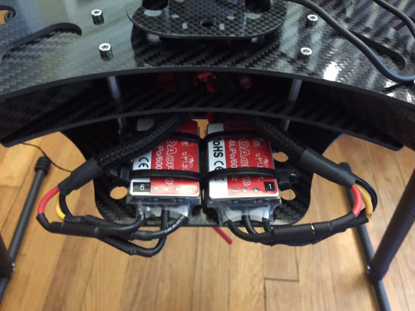

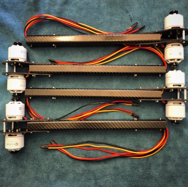

OK guys making some awesome progress on my Hexacrafter X8. This is the 850 version with Avroto 3520's. Perfect rig for the M5/H6 and it will be used for just that! The quality of this airframe is simply un matched. It's simple, strong and elegant. The Carbon is unmatched for quality in any kit I have ever seen... this rig is going to ROCK!

Mojave
Will you adjust the arm at the motor mounts (sand) so all the props are level and in the same plane?
Probably fly first and see if it needs it.. I think with an X8 that's less of an issue as it is with a flat hex or onto.
Also, speaking with Andrew, I am going to bump off the mast and mount the puck to a layer of carbon, the whole area is shock mounted and having the mast there could cause some unwanted vibrations. Andrew has thought of it all....
Motopreserve
You could also shim the motors. McMaster has a pretty reasonable shim stock pack with plenty of sizes and more than you'd need.

I don't mind snipping the shim stock myself - and that way I have a ton of spare thickness etc.

I think it's made to specific sizes so you can adjust at like .25 deg at a time? I'm sure Andrew can pop on and explain. All I know is he has em, and everything he designs is pretty awesome, so I am thinking the ones he made will , well... be awesome. :D
Mojave
Yes I am a 'student' of Kloners' - a shim kit sound awesome. Steve looked at my iOSD II flight data and showed me the motors that were fighting each other. The goal was to get a bit more flight time and work with motors that did not get as hot.
