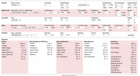

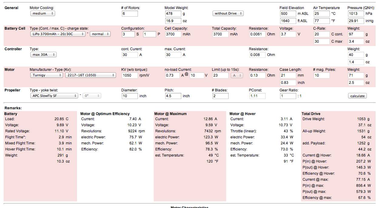

I am about to order this hexa parats today, im not sure if i did it right on the eCalc but what do you think? can this fly smooth? or will this even lift from the ground?

here is a screen shot of eCalc, everything looks fine. ITHINK::confused:

Check your all up weight again, with the motors and esc's you listed I get almost 600 grams from just them. Looks like you just put the bare frame weight in there and forgot about all the other things you have to lift.
alvinrenz
on the eCalc it say drive weight is 1053g i think this is the motor,esc and battery. and the frame weight without the drive is 478g. all up weight is 1531g. if i am correct with the calculation.
