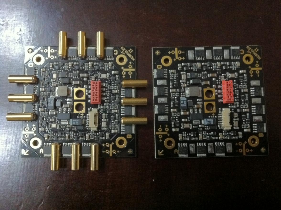

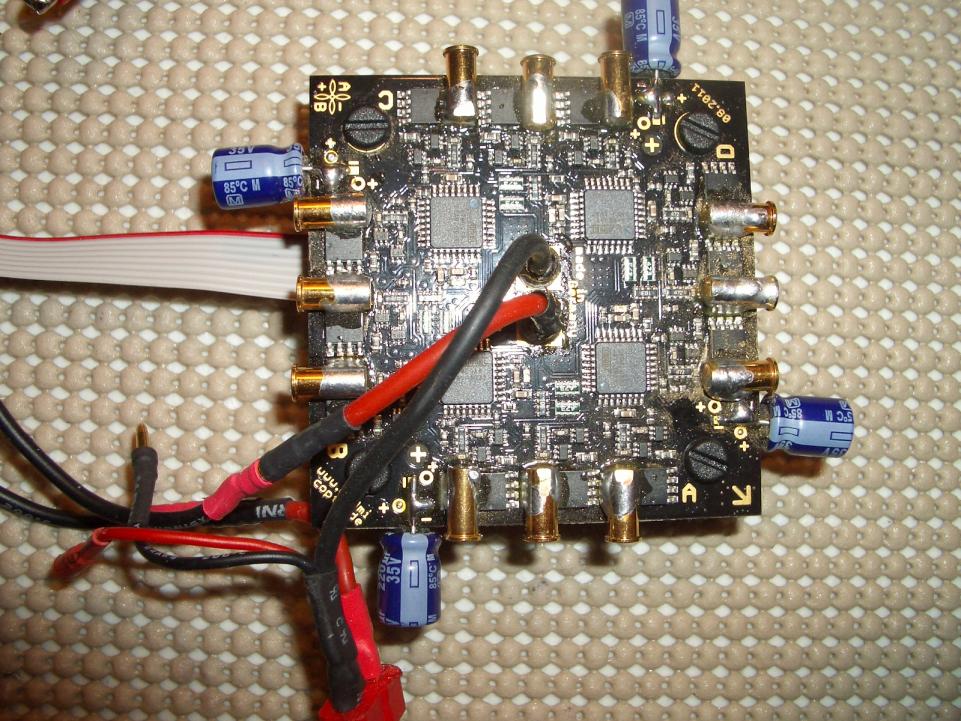

View attachment 1519View attachment 1520
jesus !!! what the .... i would have send this board back right away !!!!
This is the what the soldering of the gold connectors should look like. Anything could of gone wrong with that amount of solder !!!

And it would acutally be better to solder on cables with bullets right after. The bullets are a nice idea, but you constantly have to check them that they didn't loosen because of the vibrations. I still have to do that but to lazy at the moment
Hi Andre,
But can you measure something on the third pin from the red ribbon. It should give you a 9v5 out put I think, from the Herkules board.
Boris
Just an afterthought, it is the PPM1/V+ (BEC) that i actually measured in the picture of my first post and as you can see there is no 8.5 or 9.5 or whatever the BEC outputs.
That has worked to my advantage when i had everything connected to the Rx as i'm using Dragon Link which can only take 5V so i would've smoked it.
I quite agree with having wires soldered to the pads and connectors further out.
I had that with my MK ESCs.
This board being new to me and seeing some photos on Andreas's site i thought that is the way to go.
