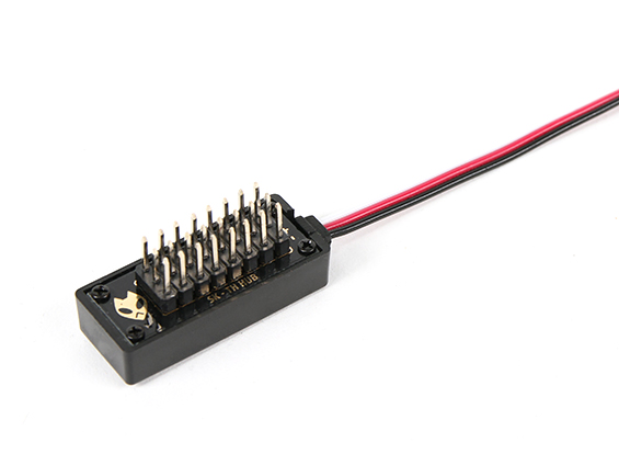

I have a calibration hub from HobbyKing. Is it feasible to use that?
Motopreserve
I've used something much more basic than that to calibrate multiple ESCs at once. Just a 1-8 homemade harness, but I've never had any issues.
I would think you'd be fine.

Secondly, I used to use & recommend a Multi-ESC calibration hub/ medusa snake cable, but again had cases where all ESC did not perform the calibration. I have fallen back to recommending on ESC at a time so you can hear each ESC and confirm that the calibration beeps occurred on each ESC. When you have 6 or 8 ESC trying to calibrate at the same time, it is nearly impossible to confirm they all did the correct beep sequence.
