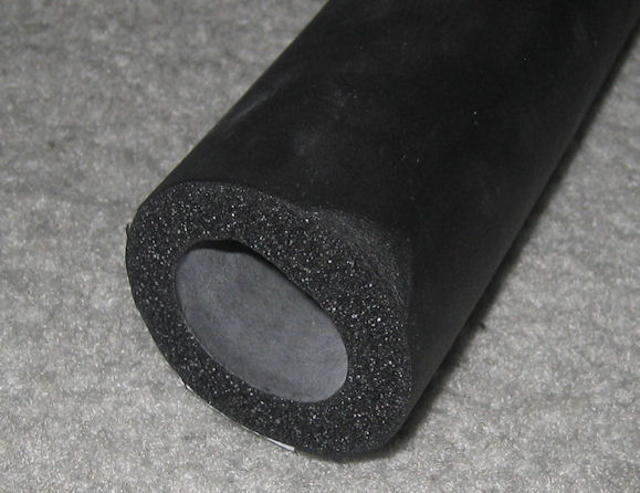

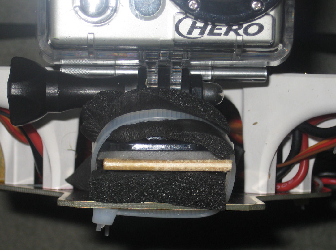

No, there was no additional stabilization (at this stage). I mounted the GoPro to the front tab of the flame wheel's base plate (I positioned the tabs as fore/aft rather than side to side as some do). For vibration suppression I use a section of rubberized tubing designed for thermal pipe insulation (from the plumbing section of the local hardware shop). Its a very gooey rubbery foam that absorbs vibrations very well. I placed a section under the GoPro mount then cable tied the mount to the tab on the flame wheel's base plate. I also placed a strip of the same foam under the cable ties so they couldn't transfer vibration to the GoPro mount. The result is no jello and a nice sharp image (especially when the lens is dry).
For COG balance I mounted the battery across the rear tab on the base plate and the result is a neat and balanced package.

Photos below of the GoPro camera mounted on the DJI Flamewheel Quad. Its only a temporary mount but it works well. The empty top plate leaves room for FPV equipment.
The eventual plan is to hang the camera below the frame on a tilt/only gimbal controlled by the Naza. To me, roll is part of the flying experience so Im not planning on eliminating it through the camera mount (yet).:friendly_wink:
Also included is a photo of the plumber's thermal pipe insulation which does a good job of reducing vibration.:tennis:
