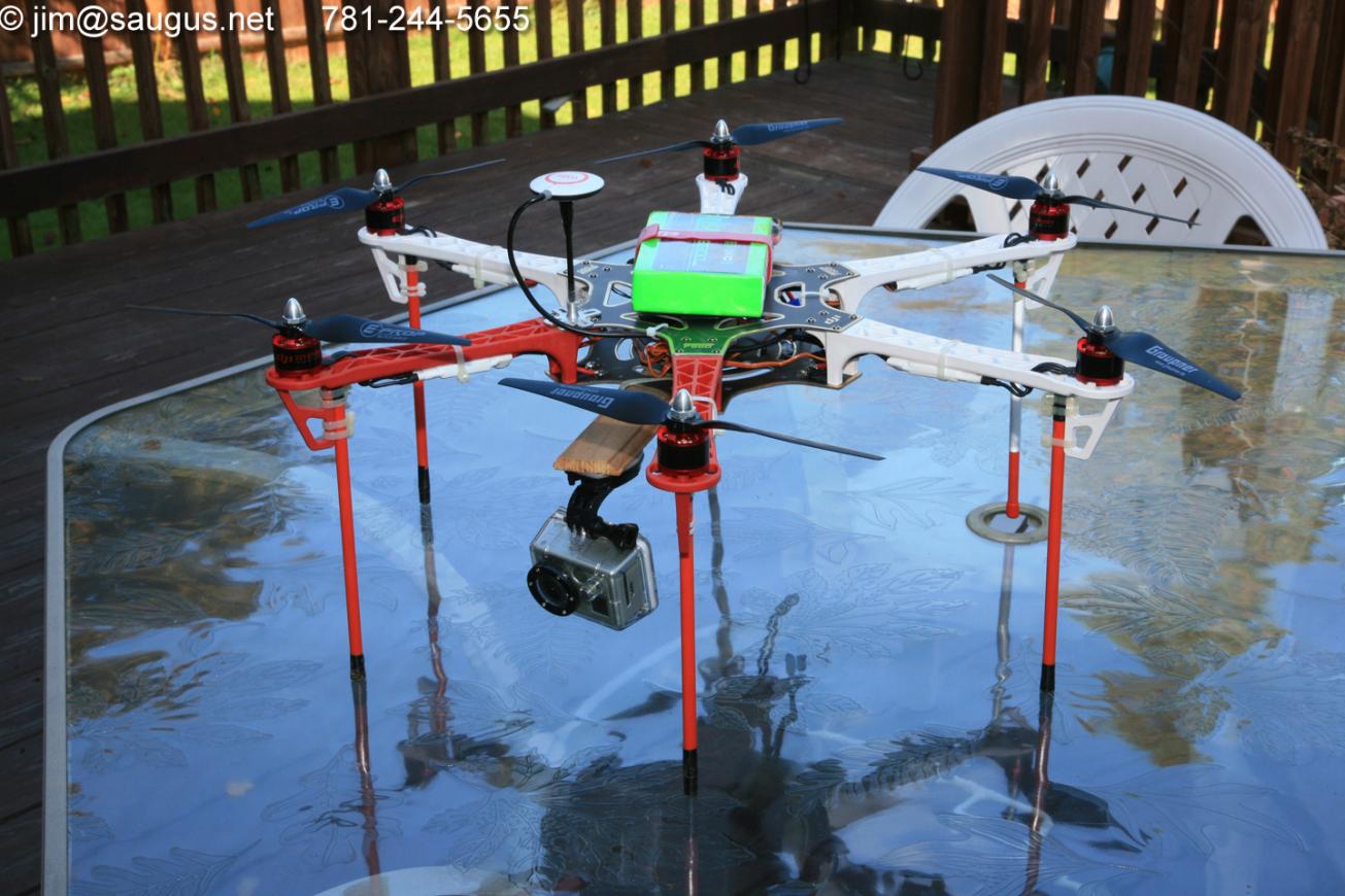

I fly a DJI F550 with the Naza Controller and GPS along with a Spektrum DX8. Anyone out there with this setup? I could use some help with a couple things.

Hey here Jim. Still a noob to this so I hope this makes sense. So I have been flying in Manual Mode since I built my F550 because I have not yet been able to get my GPS or Atti mode to work properly. I've set and reset my GPS, I have followed all instructions on the manual and Youtube, and still no luck. One thing I have noticed, is that my LED indicator only blinks green when in Atti Mode, GPS, GPS Calibration and fast green when in Fail-safe. I contacted DJI and they didn't provided much help to troubleshoot. Would the LED indicator cause a the GPS and Atti mode not to work? DJI told me that the LED combines Green and Red to make yellow. I dont think my red LED indicator works becuase when I start up my Flamewheel, I no longer see red flash. I do believe it goes into GPS Calibration when I attempt to calibrate because the LED indicator lights up and stays green instead of yellow because there is no red to combine. It stays green until I complete the calibration process. As well as when I try to fly in Atti mode the LED blinks green instead of yellow. But when I try Atti Mode or GPS, it elevates really high until I go back to Manual mode and bring it down. Any ideas?
