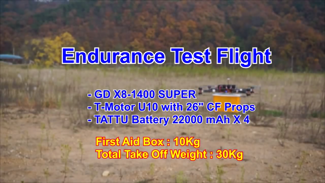

Another place to look at for long flight times/heavy loads is a copter that Mr. Fu over at Foxtech developed. He calls it the Devourer http://www.rcgroups.com/forums/showthread.php?t=2213490 It'll fly over 50 mins with no load. And he's managed 19 mins with a 7kg payload (18kg AUW)
I think that is about your upper limit on flight time / payload
And not suggesting you buy one, but rather have a look at the process Mr Fu went through. He has his hands on anything he wants so it's a good bet he's found good combos
Pumpkinguy

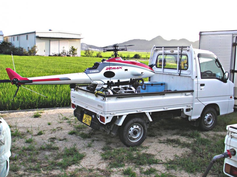

I think a gas or turbine collective pitch is the way to go. You will have hours of flight and be able to lift your weight.

The only thing i have seen that does that kind of payload and flight times is the crop dusters in japan. The thing is huge dangerous but gets the job done I have seen bigger ones than this just a example of rc madness
Just need a small truck to transport though! ;)
