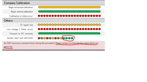

I'm quite a new for NAZA-M LITE. I've not yet skimmed all the threads but let me take your time to solve my question. Just bought NAZA-M Lite and wired all the necessary peripherals like receiver, ESCs, ... I turned on the transmitter, Futaba T14SG, and power to the flyer and checked the bind Tx and Rx is OK. But, the LED on the VU of NAZA-M shows different than the sequence shown in the manual. My unit shows the green flash only 3 times while the instruction shows that it should be 4 times. However, my unit still can not be connected to my PC via USB. I tried Windows 7 64bit machine and Windows XP machine both along with the installation instruction. Is the connection with PC is the things to do first? Otherwise, the LED pattern showing my unit can not become correct?:upset::dejection:

Yep, mine does the same thing too. finishes with 3 green flashes. I took took it back to my local dealer, who checked it out, and said it's working correctly. As far as I can tell, it's an error in the doc.

:sorrow:Wow! Thanks for the input, smackenzie. Is yours connected with PC flawlessly? If so, I envy you! I can not solve this as if I threw a money....
Yes, connects with PC just fine. In fact, I've got it connecting to Windows 7, running in a Parallels VM on a Mac :) the dji tool runs better there than on my windows 8.1 PC... I hook the USB cable up first, then plug in the battery.
Actually, it's worked in reverse sequence as well - to be safe, remove props, fire up the copter, then plug in USB. Be sure you've got the NAZA driver installed. Once you plug in USB, you should see LED go solid green. Launch DJI assistant, and if it detects the NAZA, will check it's firmware, and show "MC Output Off" mode.
